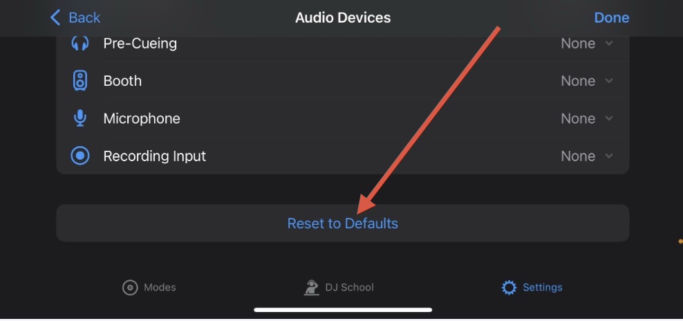

Thanks for confirming @HORAZE-MUSIC. With the V5 connected to your iPad, please use the Reset To Defaults at the bottom of the djay Settings>Audio Devices. Do not adjust the Audio configuration after performing the reset. Retest after performing this and let me know if it helps or not. Thanks!
