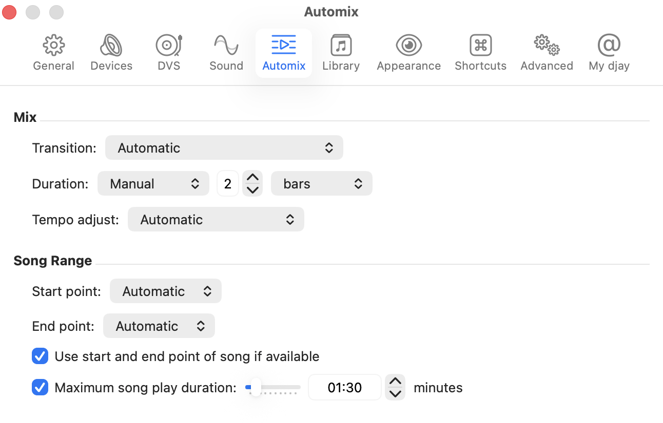

  2. Can you please also share a screenshot of your Automix Settings screen? Thanks!
Yes of course! Thank you for the quick reply, this is a bit of an emergency! I’ve attached a screenshot of the Automix settings and a link to a recording of the issue. You can see that despite it not being next on the playlist or in the queue, Get Down On It plays after every other song while the rest of the playlist continues normally. Even skipping or ejecting it doesn’t seem to get rid of it.

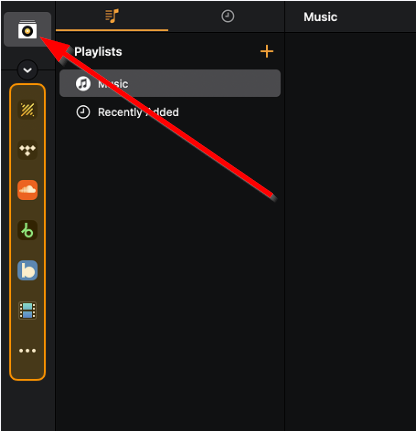

If that doesn’t work, please try recreating the playlist from scratch in the My Collection Source rather than directly within the Spotify Source. Then simply add the same Spotify songs to the playlist in My Collection and retest Automix from that playlist instead.

Can you please also share a screenshot of your djay Settings→Automix menu?
I noticed that it is not with all songs from spotify. the songs that came along with this problem, i put in the playlist i mentioned earlier.
Hi @JeroenDutchy1, thanks for the recording and the settings screenshot, that makes it much clearer. Your video shows exactly what you described. Once “On The Floor” lands in Deck 2, it never gets swapped out. Each time it finishes, it rewinds to the start and plays again, and every new song from the playlist gets loaded into Deck 1 instead.

  2. Click My Collection, open the Playlists browser, then + > Add Playlist. [screenshot: My Collection + menu showing Add Playlist]

  1. Click My Collection in the sidebar, not Spotify.
  2. Open the Playlists browser, then click + > Add Playlist.
  3. Drag the songs from TEST DJAY into the new playlist.
