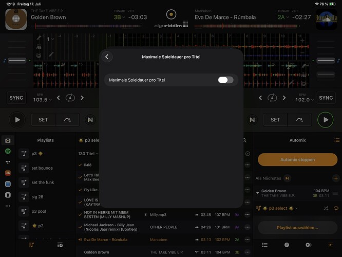

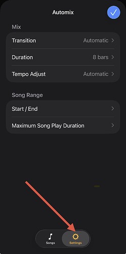

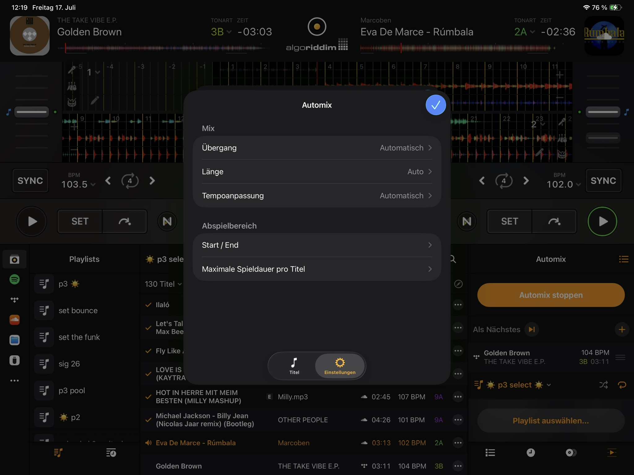

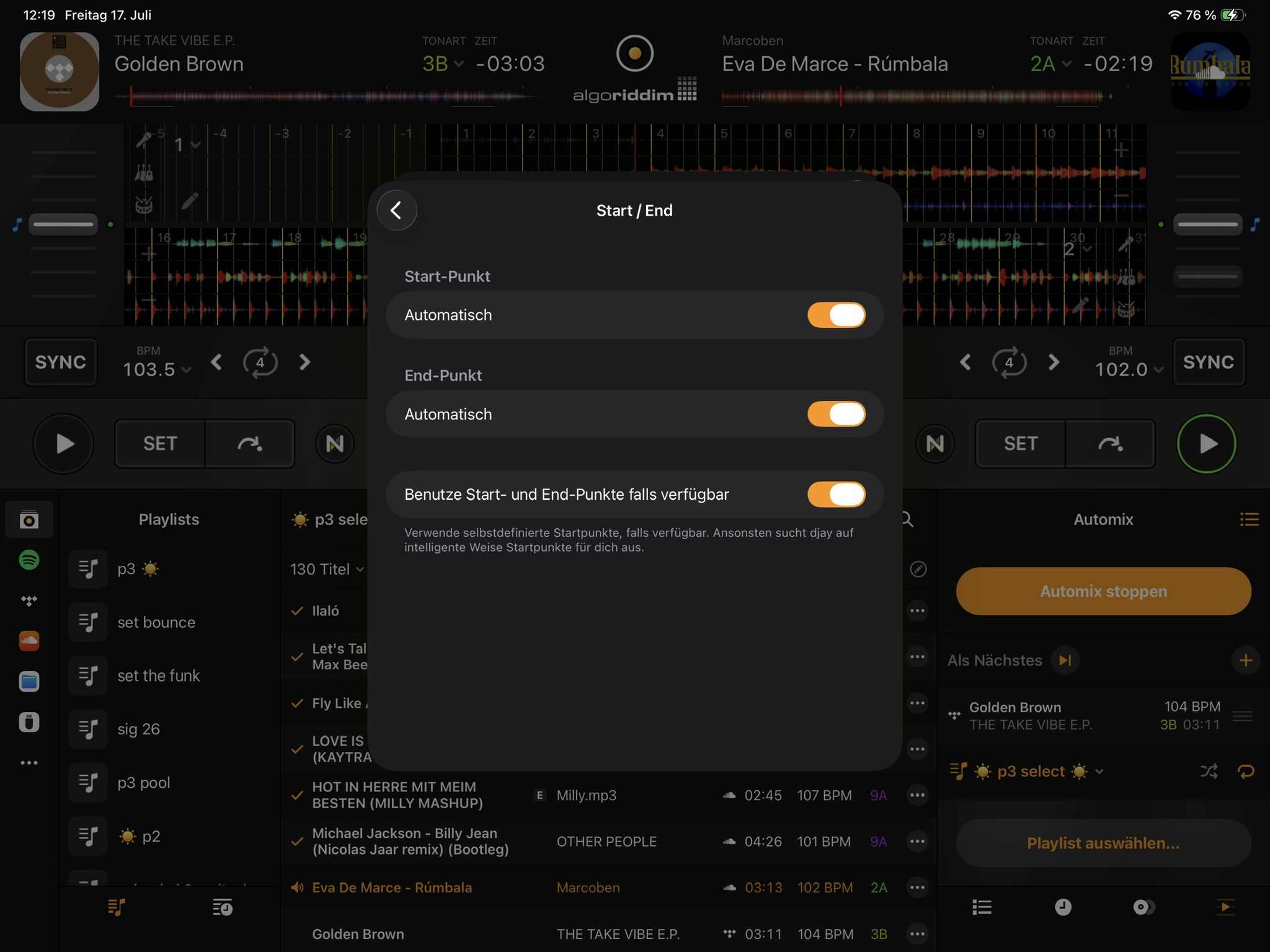

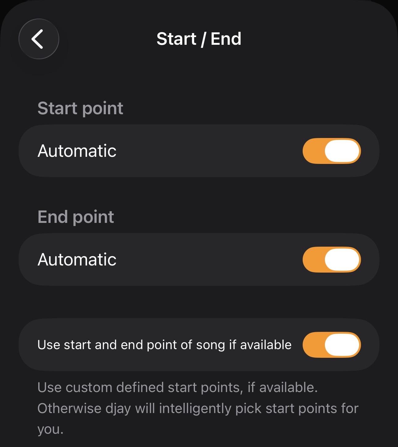

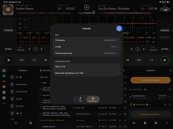

  1. I see that your Automix Playlist contains songs from multiple streaming services. Can you please confirm that you are logged into to all of these and that songs are manually loading as expected outside of Automix?
  2. Can you please share screenshots of your Automix Settings?
  3. Which FLX do you have? The FLX2, FLX4, FLX6 or FLX10?
  4. You can download and install the latest firmware for your controller from the AlphaTheta website: Resources & Downloads - AlphaTheta Help Center
Hi,
1.yes, confirmed

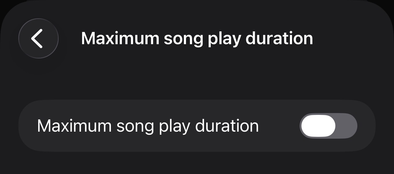

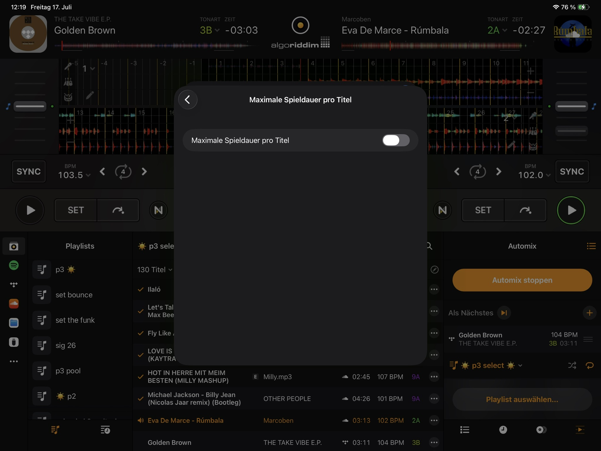

  1. attached
  1. FLX4
  2. The problem occurs during automix, when I am not using the controller. But I’ll update if needed.
