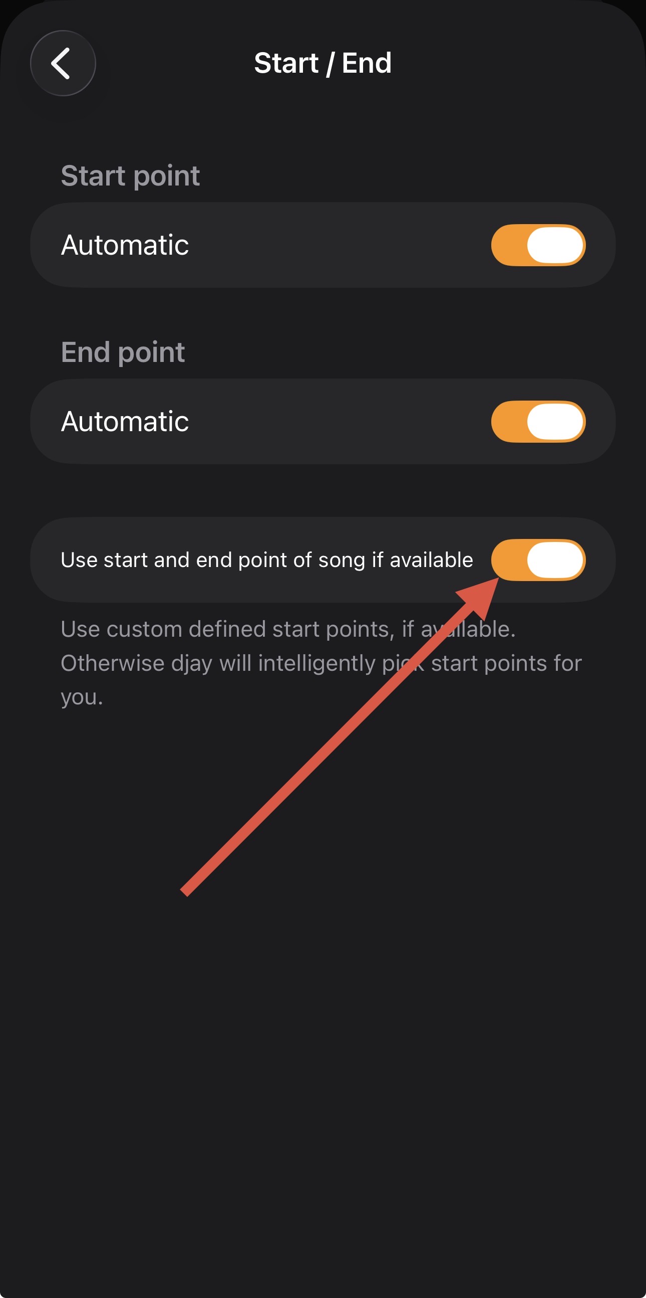

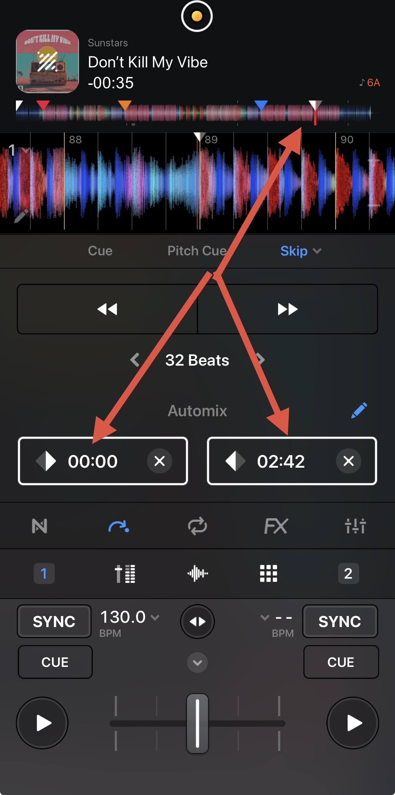

Thanks for sharing @Armigo. I highly recommend that you set Automix Start and End Points to accurately control the mix in and mix out points.
Just make a proper list and leave it there to do it’s thing, you won’t be disappointed whatsoever. If you decide to leave your transition setting to “Automatic”, watch out for the NM Echo Out - there are many times it has echoed out to a complete silence on me…that’s why I enjoy the Harmonic sustain better

I can’t offer much more advice than what has already been shared here, but my setup is simple: I use an Echo Outtransition triggered 3 seconds before the end. And yes, I manually mark the Start and End points for every track, thanks to what I learned on this forum (I didn’t even know that feature existed before!)
