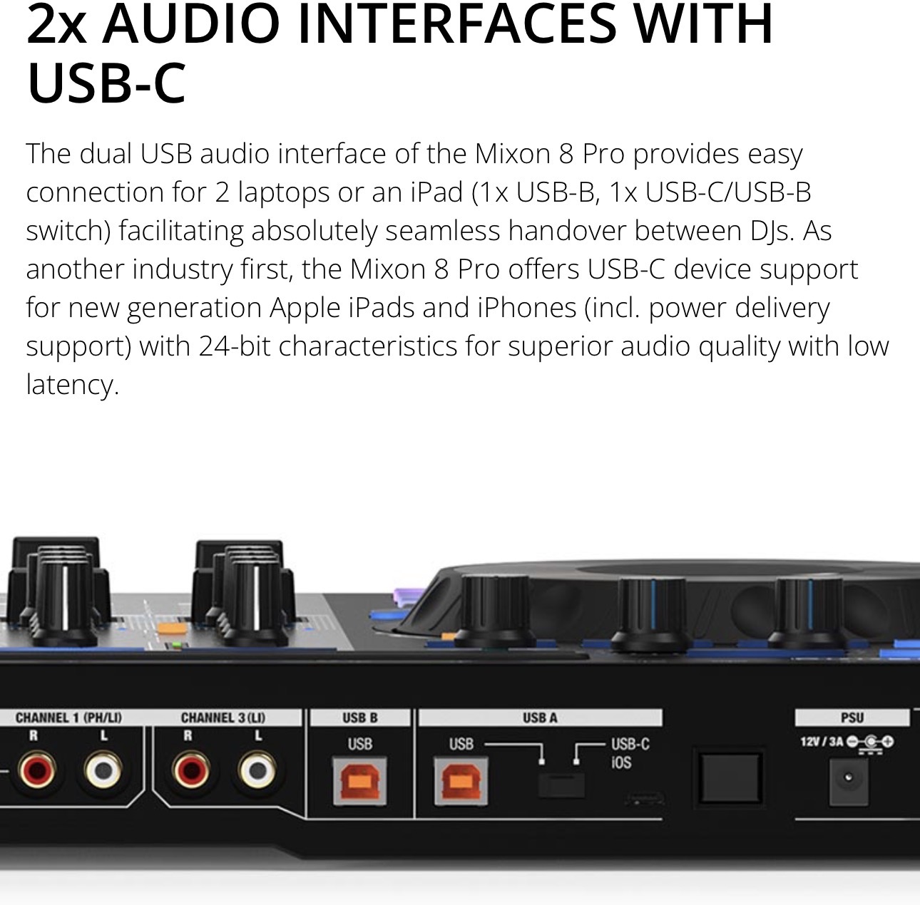

Hi @zai , check out the Reloop Mixon 8 Pro. It has dual USB ports on the back for 2 laptops. It’s also supported by djay and Serato. Each of the 4 channels can be separately routed to either of the 2 USB ports.

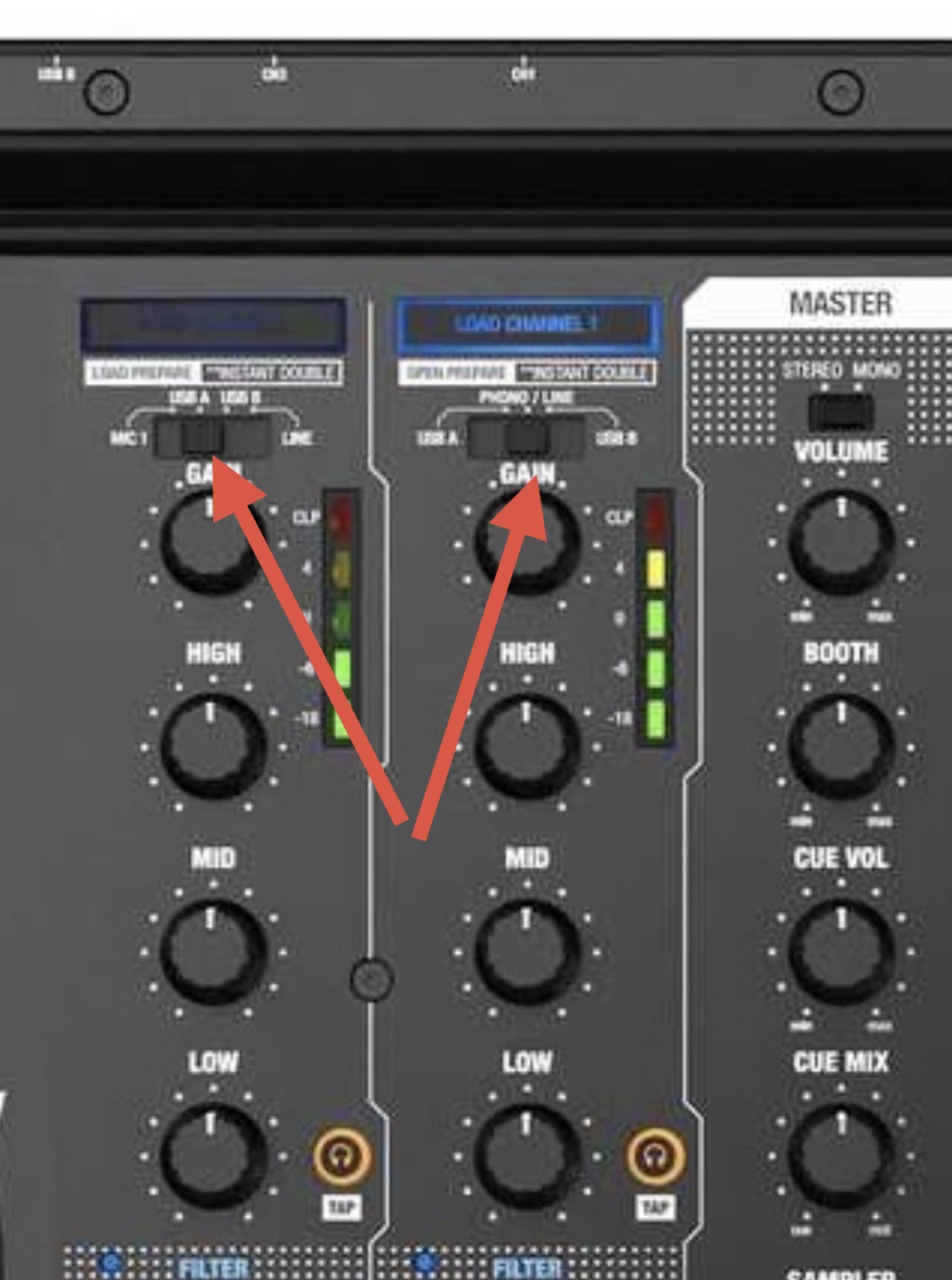

Yes @STU-C, as long as that device has dual USB ports, supports both Serato and djay, and has independent source switches for each channel. This means you can connect 2 laptops at the same time and route them independently to each channel.

Another potential DJ Controller option is the Pioneer DJ FLX10. It has dual USBs, source select switches for each deck and is supported on Serato and djay. https://www.pioneerdj.com/en-us/product/controller/ddj-flx10/black/overview/
