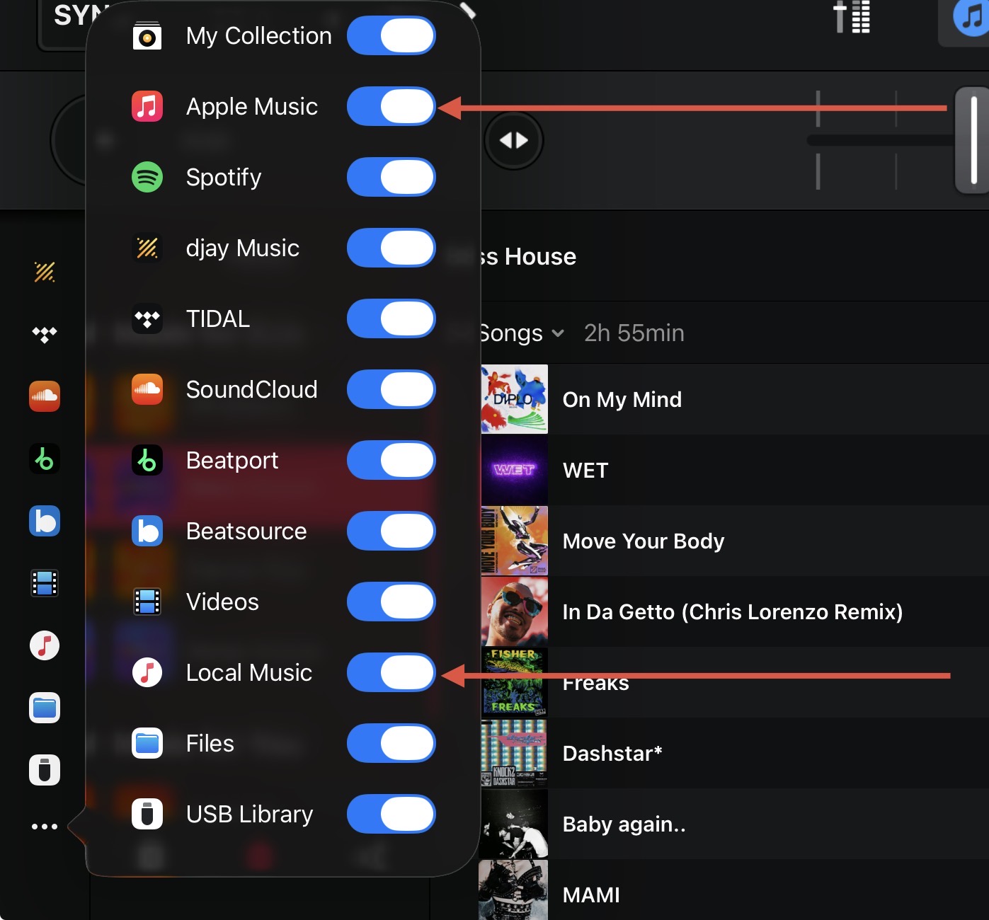

By “apple local library”, can you first please confirm if you are playing songs from Apple Music or Local Music?
Im playing from local music

If you’re using Apple Music and you’ve imported your songs, it’s possible that your file has been updated to match Apple’s version of the track. That might make it sound a bit different.
Which is sort of the industry standard. However, the setup might vary a bit because you can tweak the algorithm to better suit your specific needs.
Thanks for clarifying @GP_NS. If you used iTunes Match / Apple Music when syncing your music library to your iOS device, it likely pulled a high-quality version of the same song from the iTunes/Apple Music Store.
I dont have a subscription to apple music I never had one.
I didn’t check any option to make my private library available to other devices so this service cannot be the reason.
