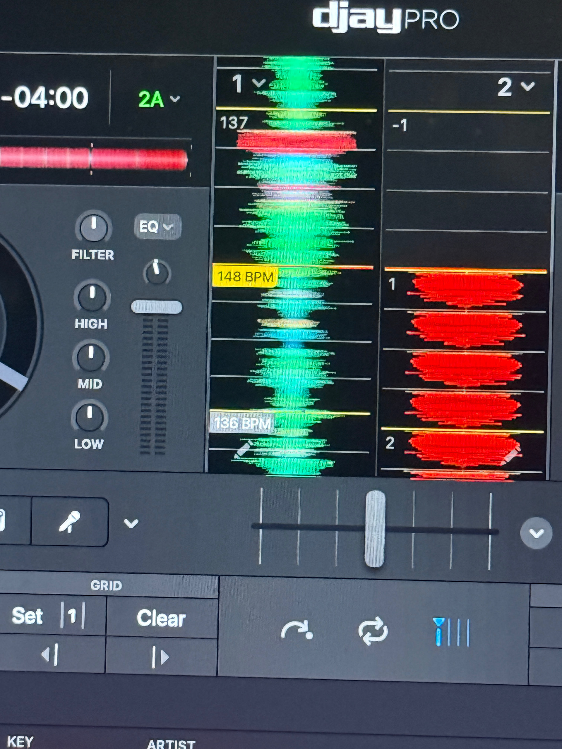

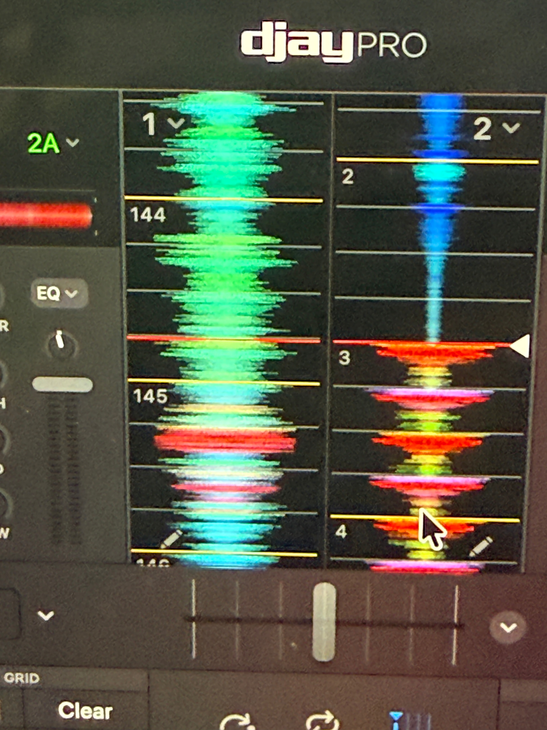

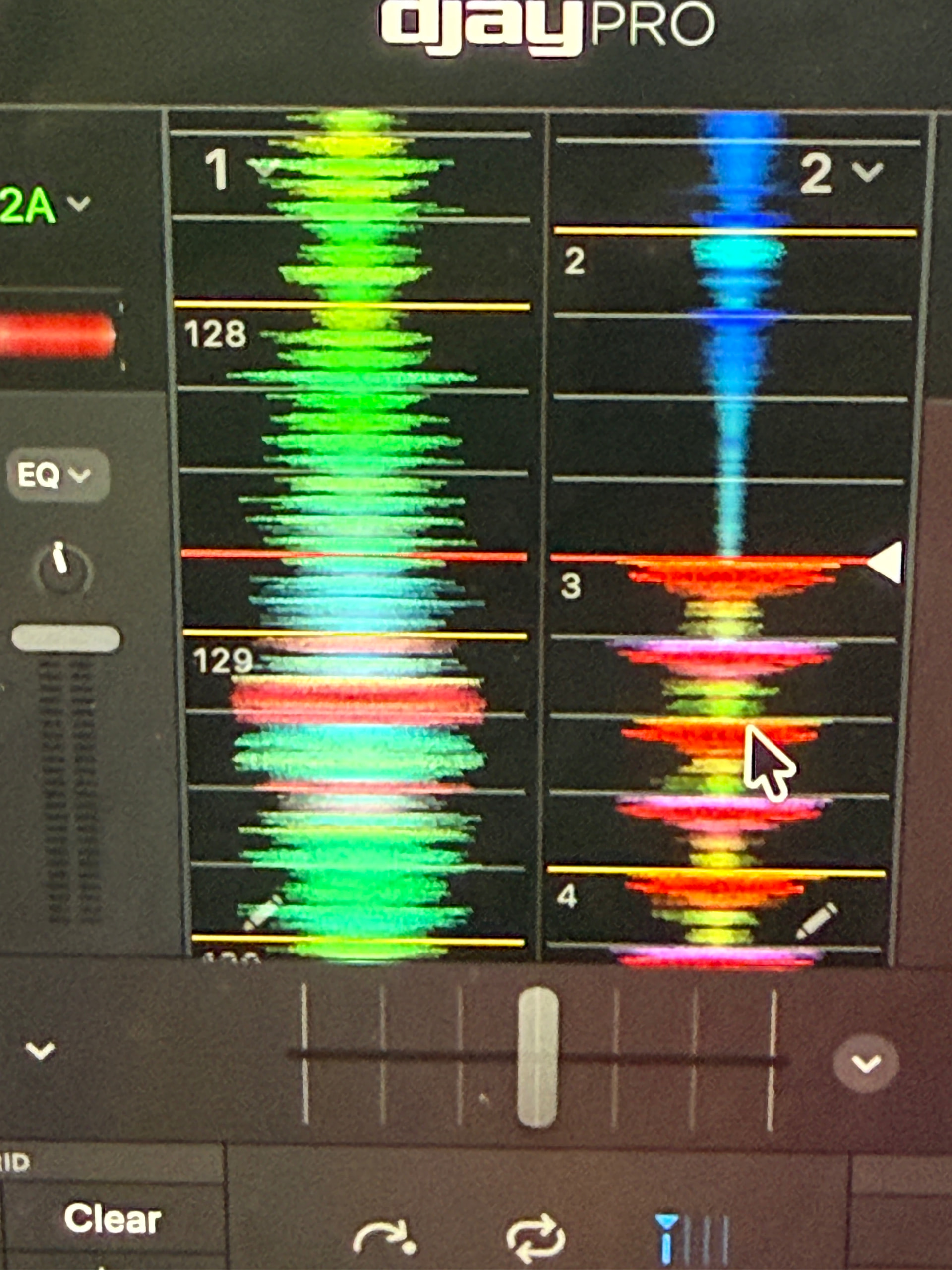

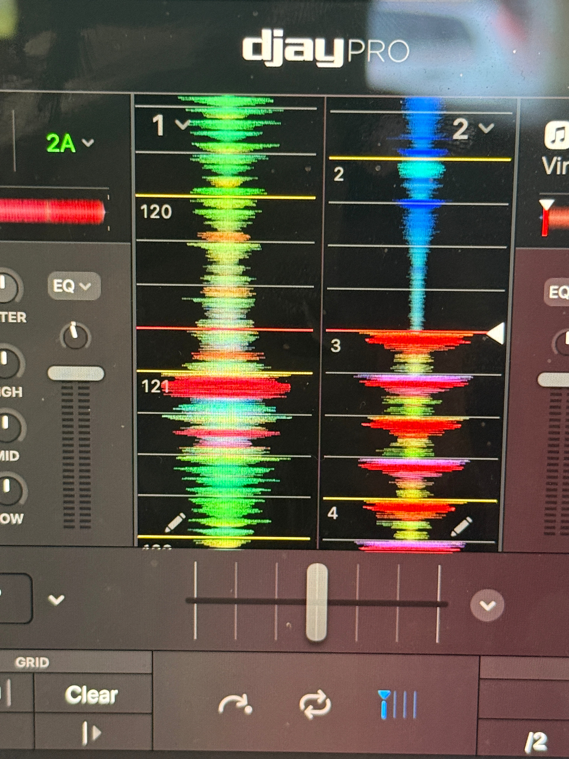

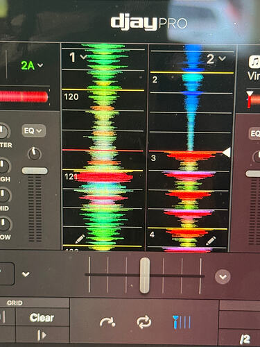

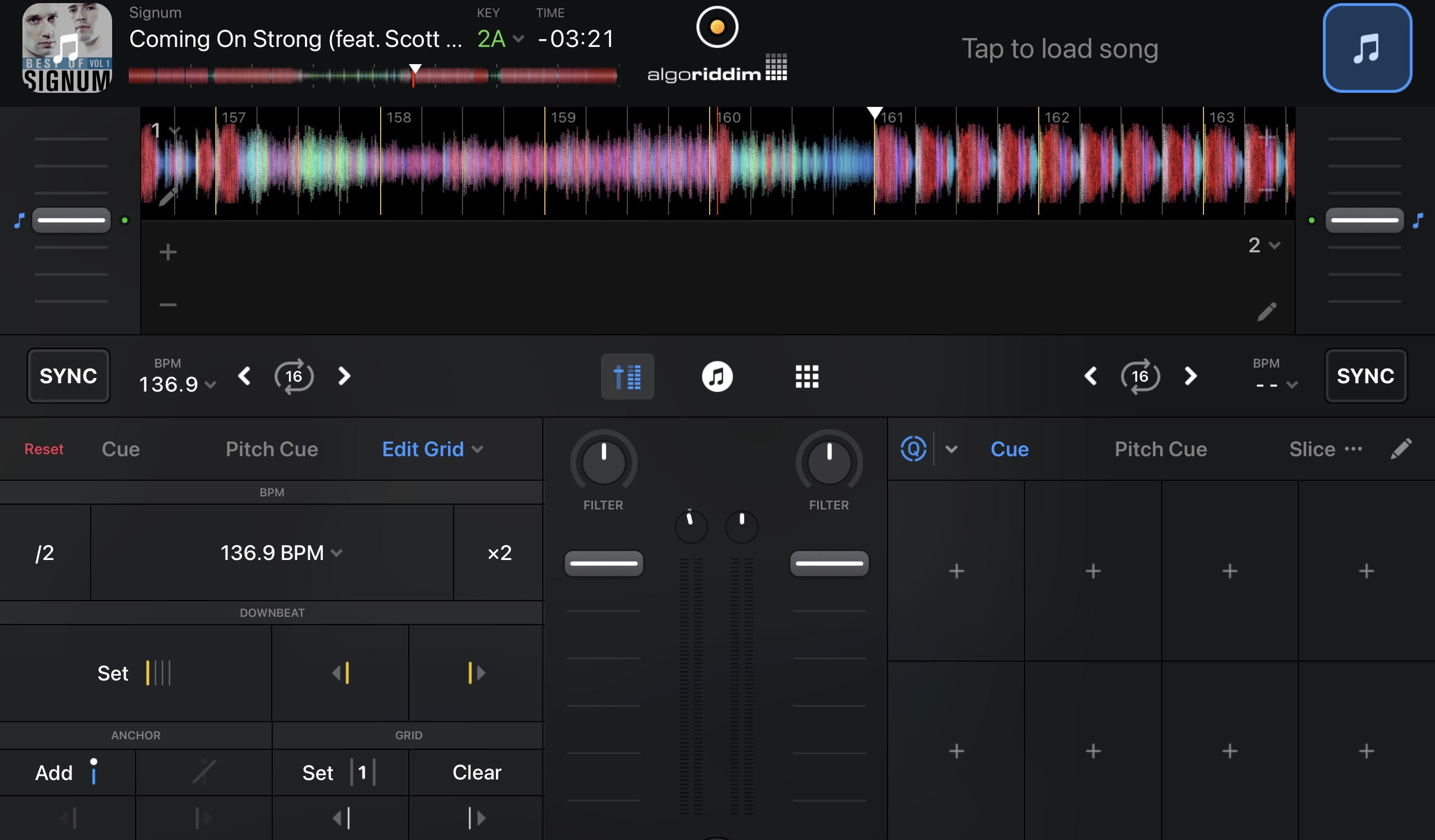

  1. I have a track that has an odd number of beats in a few bars. As you can see, at bar number 121 the beat is perfectly lined up with the bar marker, but at bar 129 an extra half beat has been added by the producer (thanks Signum), then at bar number 145 another half beat has been added and when the track kicks in after the break down the first beat is 1 beat out from the bar number marker.
  2. Is there any way to re-align the bar marker numbers to the first down beat after the breakdown ?

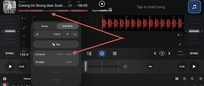

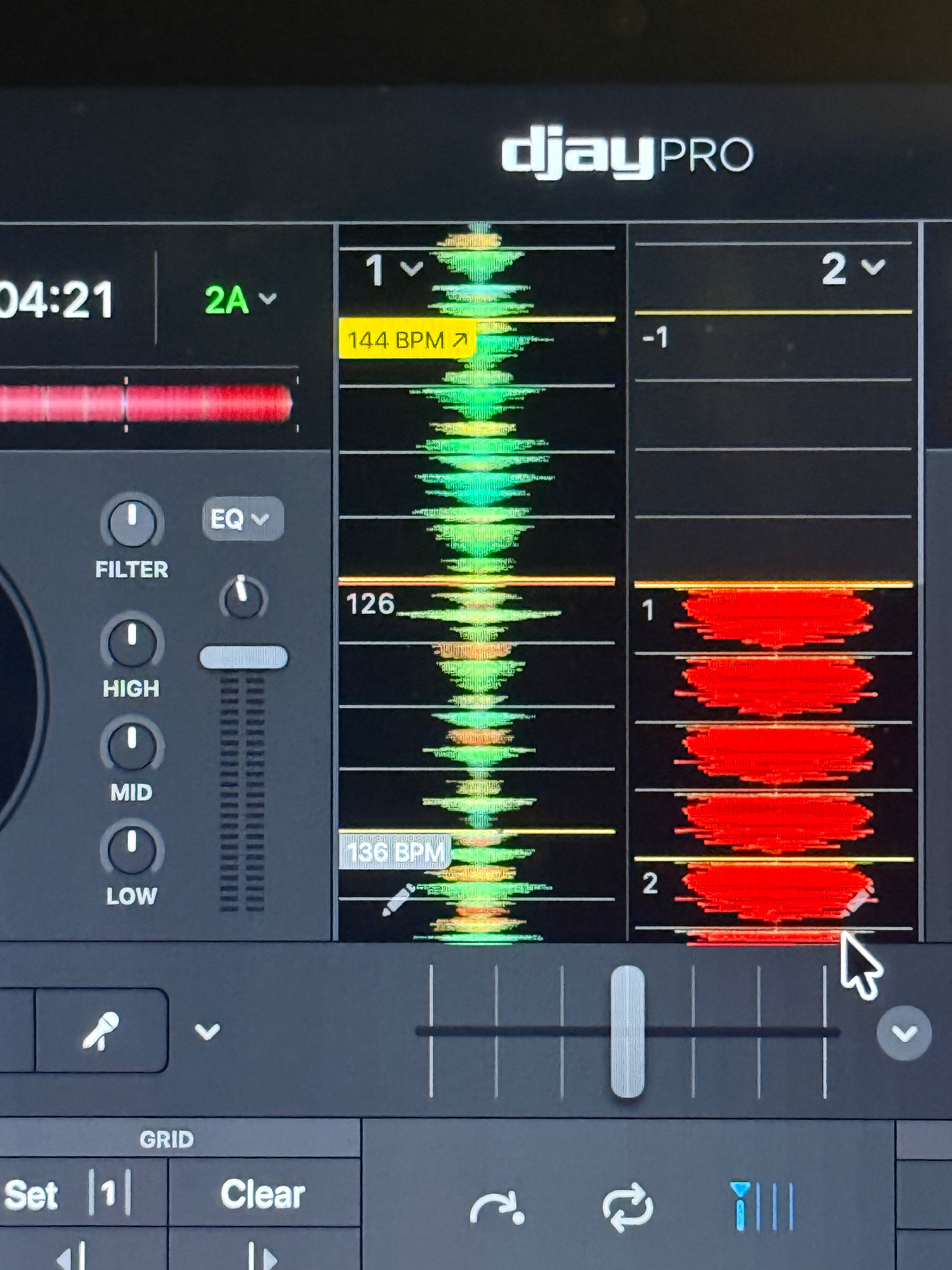

Think I’ve found the problem. The software is showing a sizeable BPM change in a few places.

I have this track in WAV format and just mixed the 2 together, one in Djay one in Ableton and they line up fine until Bar 125.

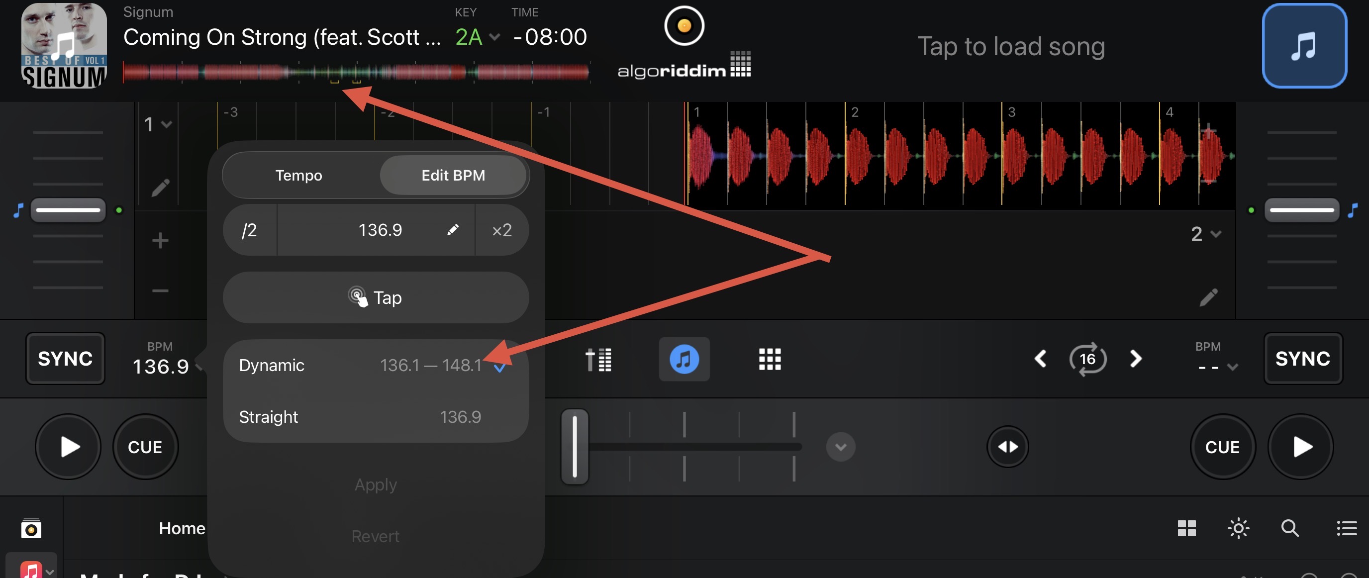

Thanks @MiQ, yes, this song appears to have a variable/Dynamic BPM. Can you please confirm if you have the BPM set to Dynamic or Straight?
  1. You could try setting the BPM to Straight. For me this seems to automatically align the bars after the breakdown.
    1.

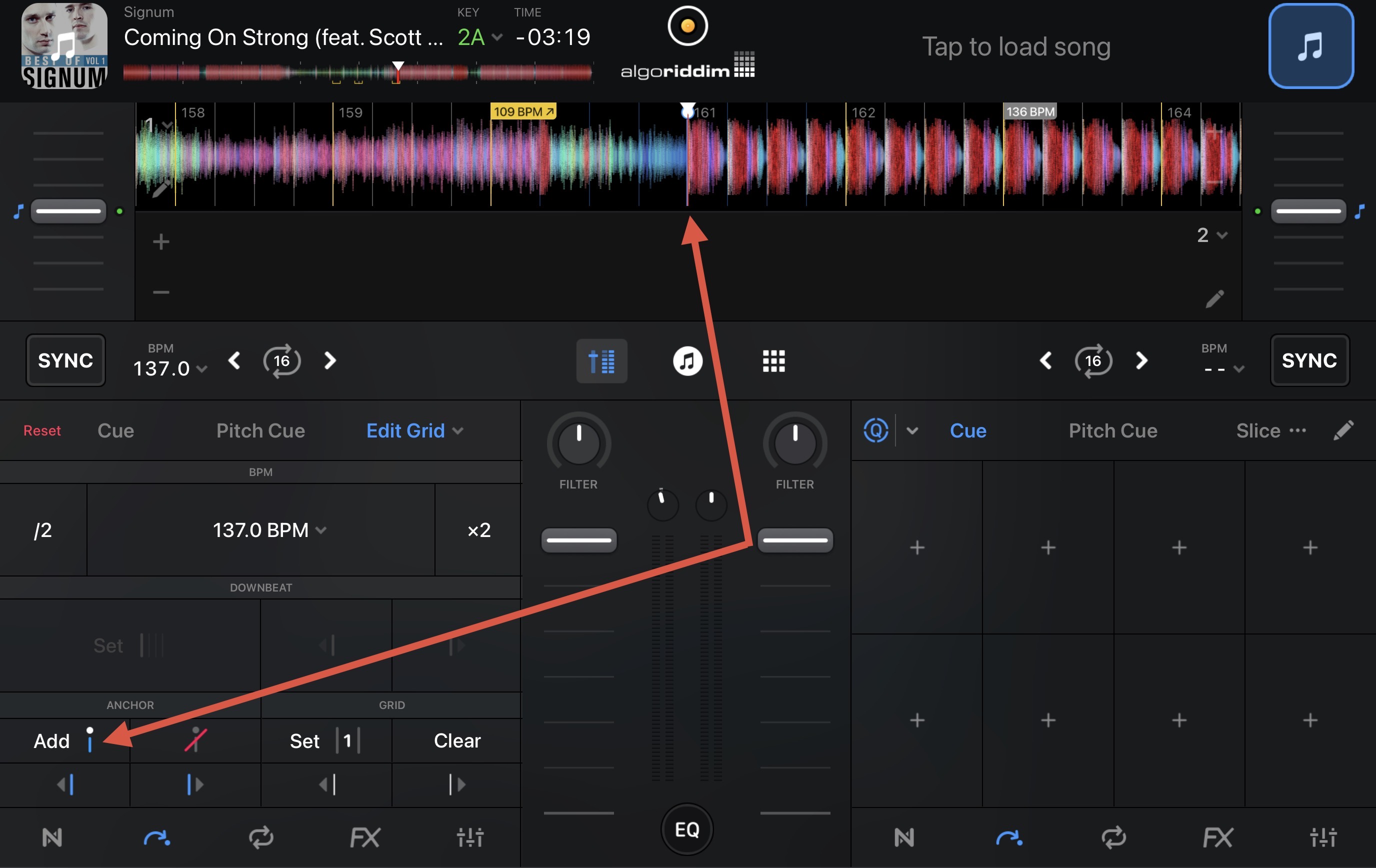

  2. Alternatively, you could leave the BPM as Dynamic and add a manual Anchor Point on the first beat after the breakdown.

The beat analyser looks to be confused at the the trancy instrumental part. It decided that the bpm changes, while in fact it is not. That is why setting the bpm to straight, gets the alignment after the instrumental part correct in the example of @Slak_Jaw . Tested the same track in Recordbox. That even gets more confused in the instrumental part, but is correct again after the instrumental. I have VDJ not installed anymore, will try that later tonight.
So it seems a good test track for the devs
Thanks @EwoutdeBoer
Thanks. Tried both setting to Straight and adding an Anchor Point. Both did the trick. In this instance setting to Straight is the obvious choice.
