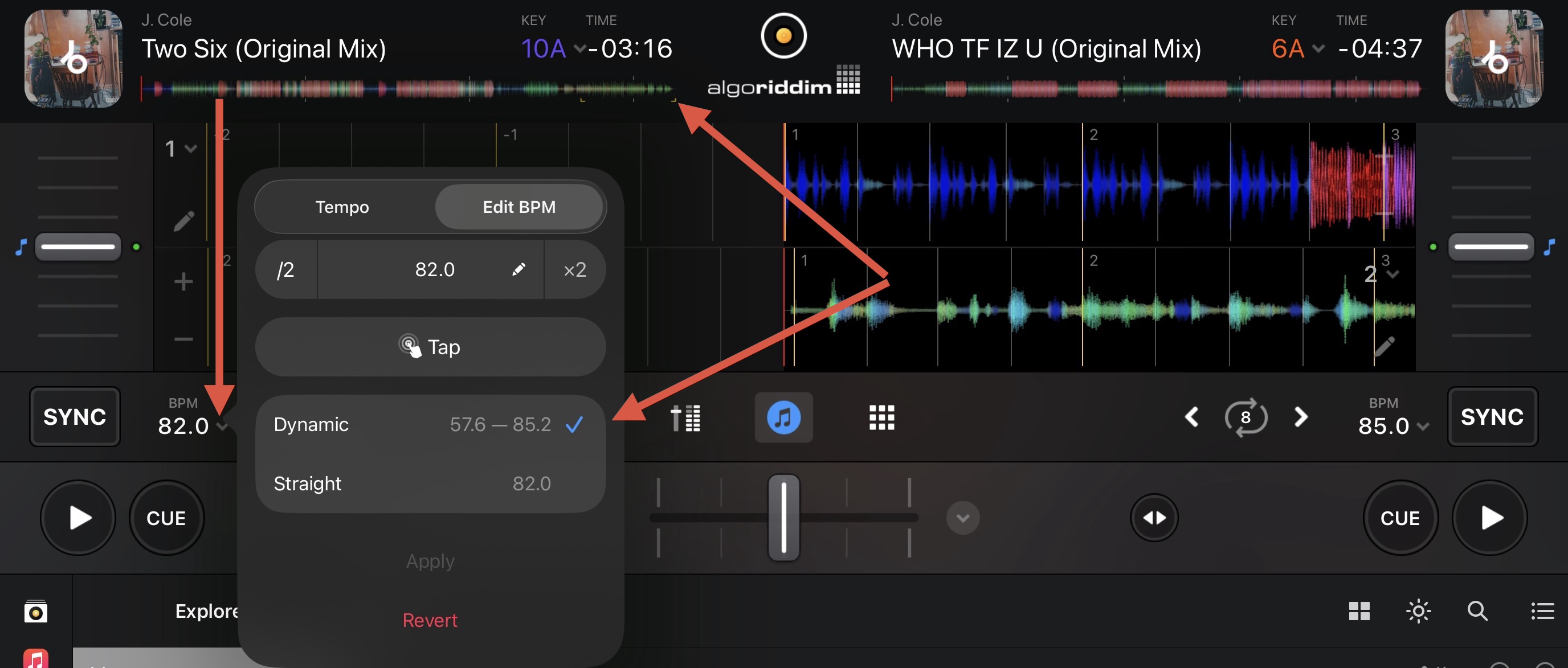

Hi @jaysnbrwn, thanks for the video. I checked both of the songs you’re using in the video and, at least for me, these are both Dynamic BPM tracks. I suspect this is contributing to your issue since you are not using Sync. Can you please retest with two Straight BPM songs instead and confirm if the issue persists? Thanks!
Hi @Slak_Jaw tested with a few straight bpm tracks, if the original bpms are quite close then the slip is hardly noticeable. If there is a bigger gap in original bpm then the slip is still there although not as bad as the video example
