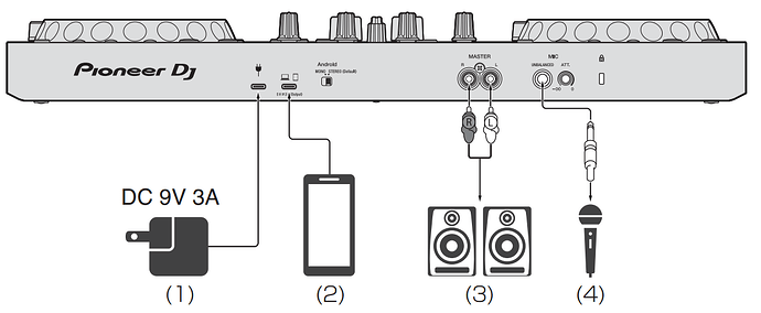

  2. Are you connecting your iPhone to the FLX4 wirelessly via Bluetooth or via cable?
  3. Perhaps a short video or some photos of how you have everything connected would be a helpful starting point? Thanks!

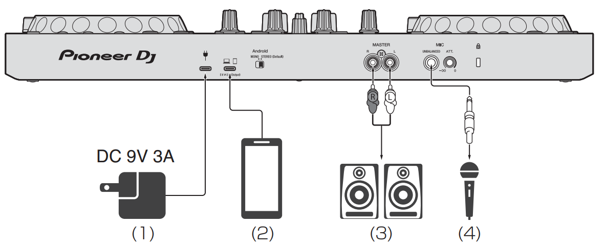

Hi @marsbee, since you have a Lightning port iPhone, I first recommend that you try connecting with a different Certified Genuine Apple Lightning to USB-C cable. Please make sure that the FLX4 is also connected to power with the other USB-C socket (9V, 3A or 27W).
If that doesn’t work please try using a Genuine Apple Lightning to USB 3 Camera Adapter, and a high quality USB-A to C cable.
