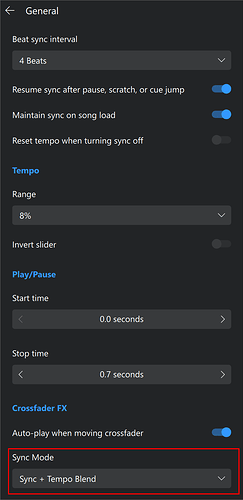

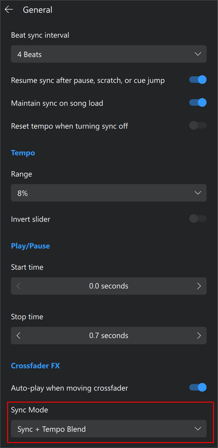

Hi again @Apos,
  1. Can you please check your djay Settings>General>Crossfader FX and confirm what Sync Mode you have it set to?
  2. Can you please also confirm what crossfader curve setting you are using on the hardware?
  1. Sync Mode in Settings is set to Sync+Tempo Blend

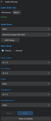

Hmmm…. very strange. Can you please share a screenshot of your djay Settings>Audio Devices while your controller is connected?
