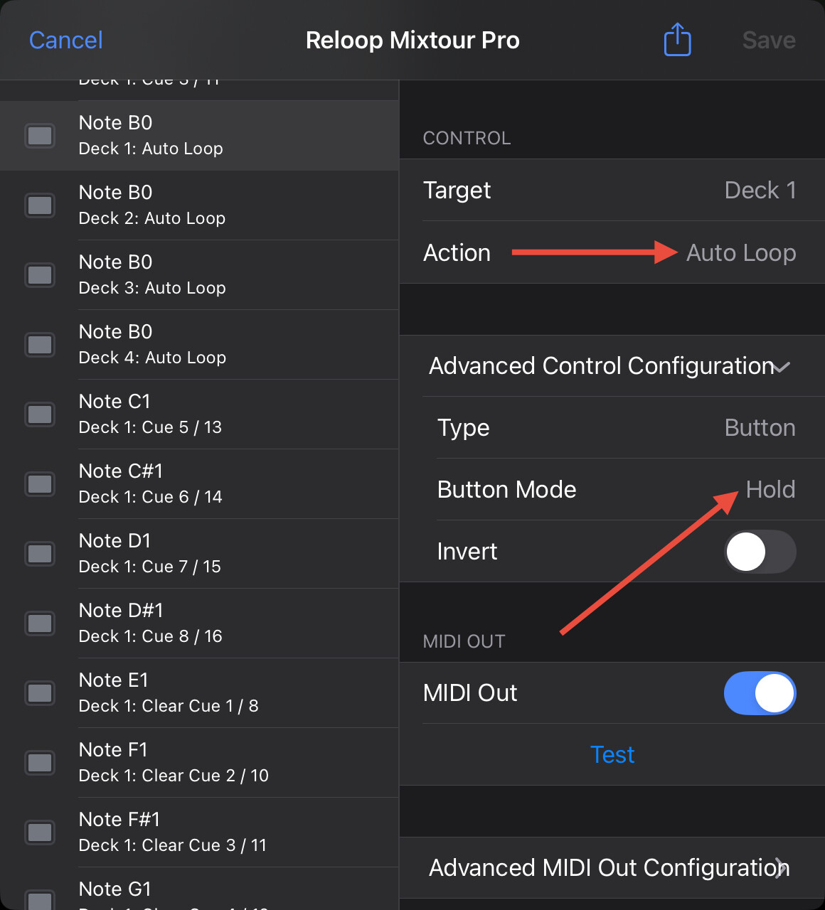

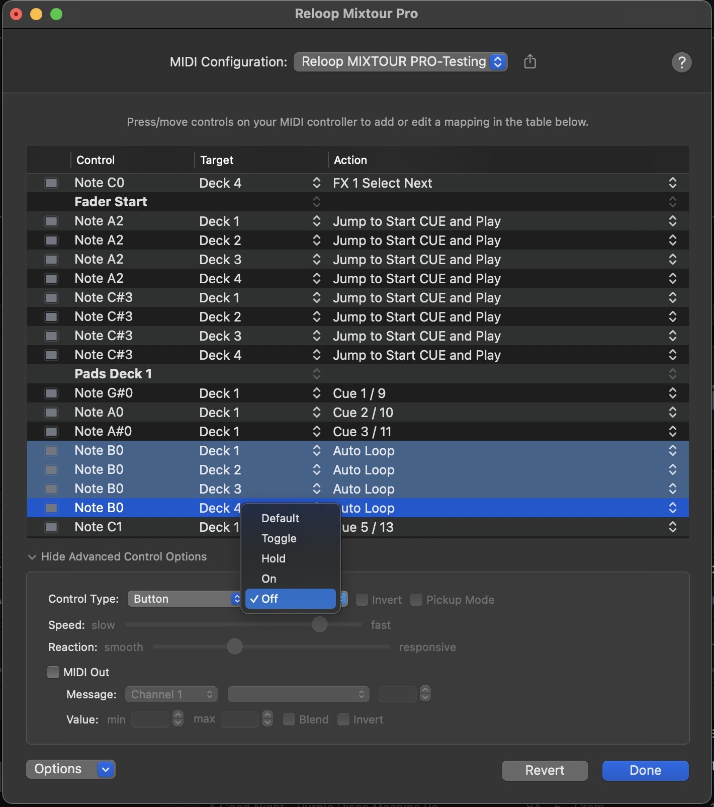

Hi again @frgld, actually there is a work around for you. If you set the Action>Auto Loop then expand the Advanced Control Options and set the Control Type>Button and set the Mode>Off.
On iOS there is not Off option for the Mode, but you can achieve a similar result by setting it to Hold and doing a quick press on the button.
I tried the iOS workaround suggestion. When I Invert it actually works for me as letting go turns off all loops reliably. The way you wrote it it turns inactive loops on for me. Thank you still as this helped me to find a solution. :folded_hands:
Interesting to see you have more modes in macOS, amybe you make them available in iOS as well.
Glad that helped @frgld
