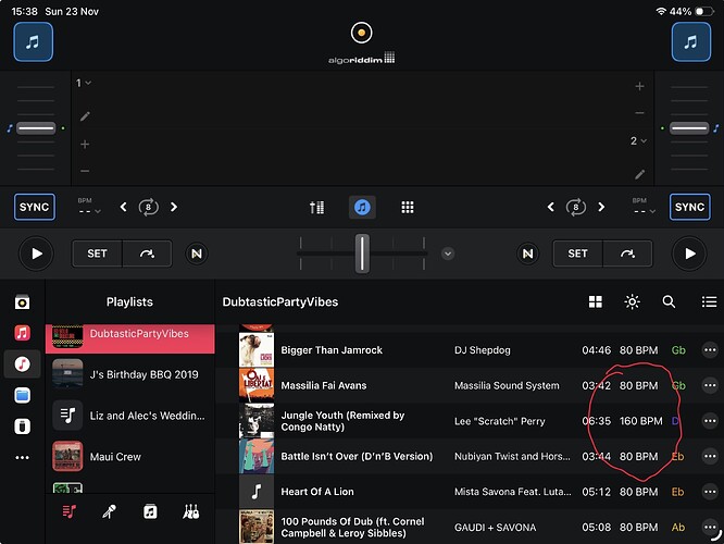

On DJ Pro on an ipad I have the ubiquitous problem of drum and bass ending up at c65bpm as opposed to 170.
Can I/How can I best adjust this so they appear at the fast end of my bpm sorted playlist rather than the slow end.

Its a headache. Halving and doubling of bpms have become quite common lately, even on my mac. What’s even more strange is that: a track may have the proper bpm but on loading to deck, you see half the bpm displayed on tempo range
Hmmmm…. It appears it partially saves the BPM but won’t sort it properly…it still sorts this as 80bpm

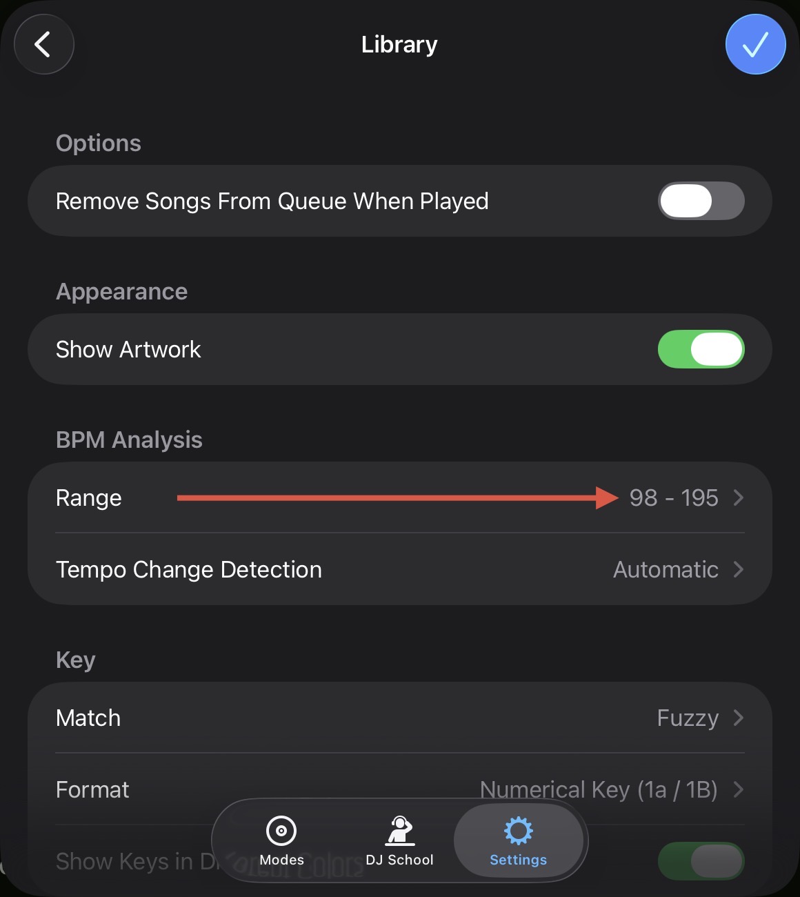

Hi @DJ.Dubious, I would try adjusting your BPM Analysis Range in the djay Settings>Library. For D&B tracks, I usually set this to 98-195.

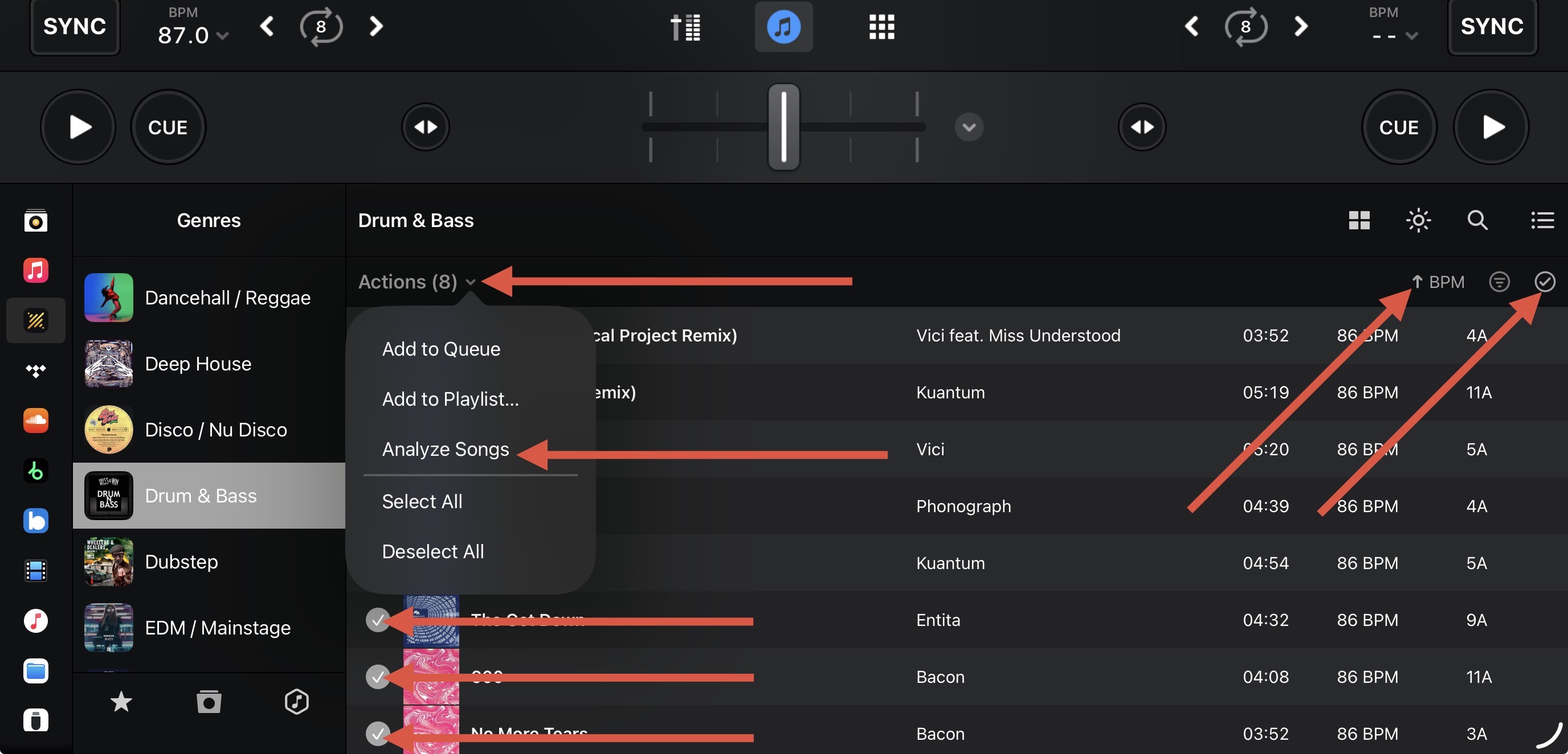

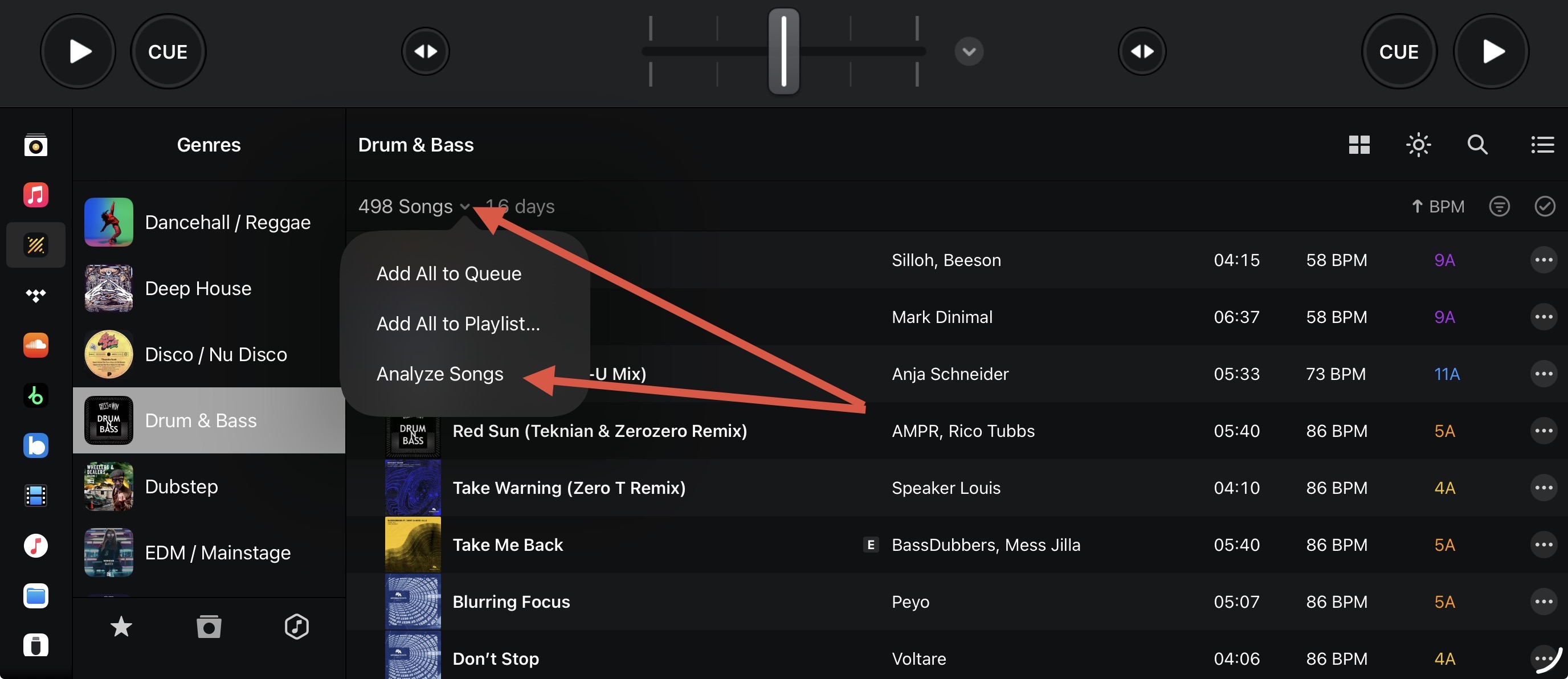

Then select the drop-down menu at the top of your D&B playlist and select Analyze Songs to force re-analysis.
If after that process you still have some songs at the half BPM, you can sort the playlist by BPM, select the Check Mark Icon at the top right of the playlist, then manually select all the songs you want to re-analyze. Finally, select the Playlist drop-down menu again and select Analyze Songs again.

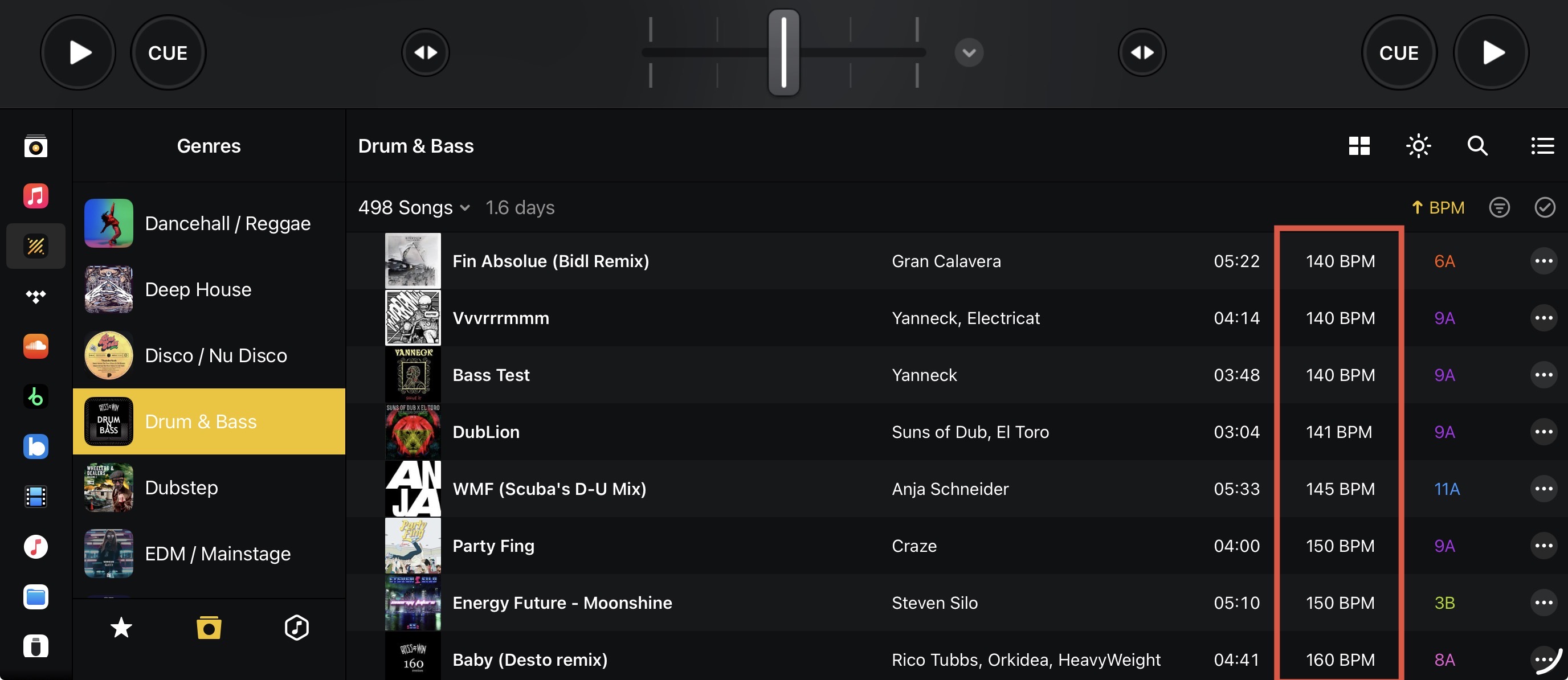

Wahey! That worked at the second stage (the mass reanalyze doesn’t appear to redo tracks that were already analyzed… I will have to wait and see what it now does with my sub90 bpm reggae tracks and if i have to do the same thing in reverse! :grin:
