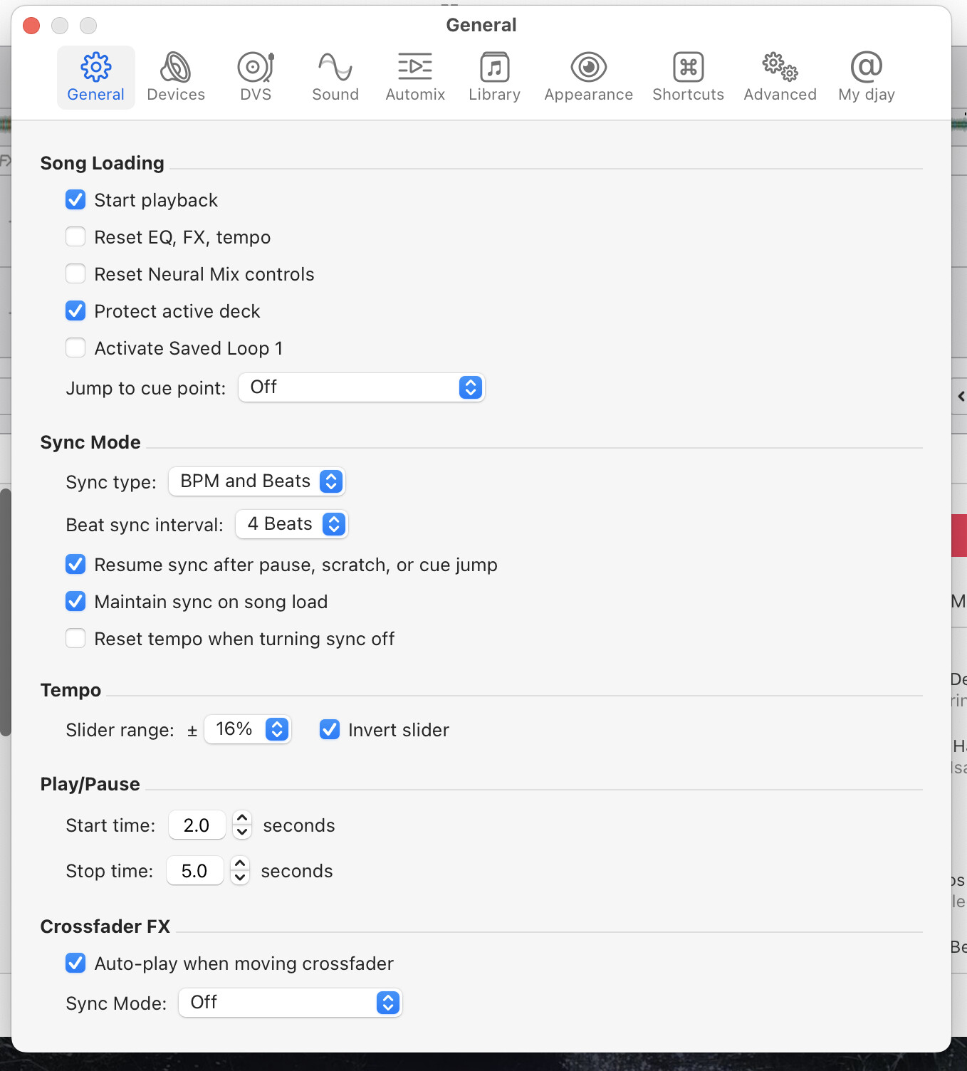

I went to Settiings-general and crossfader FX and turned it off but no good result. The resetting is still going on!
By the way, that screenshot is neither on Mac nor IOS. Advise!
The screenshot is from iOS (iPhone).

  1. Please share a screenshot of your djay Settings>General>SONG LOADING

I tested this on djay 5.3.1 on iOS 18.4.1 on iPhone and iPad and it is working as expected. With the Reset EQ, FX, Tempo setting turned OFF, the EQs do not reset when loading a new song. With this set ON the EQs do reset when loading a new song.

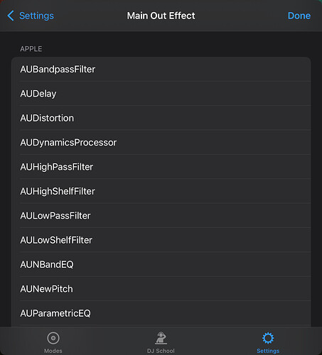

In the meantime, there is an option on iOS that you might want to consider if your goal is to simply EQ the master output signal. Navigate to the main djay Settings and scroll down to Main Out Effect. In here you can chose AUNBandEQ or AUParametricEQ
Right, I get it, but that, is much more complicated and it is actually not what I intend to mess with… having tried it before.
