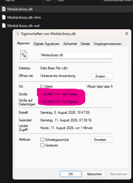

I have stopped Foldercontrol and disabled OneDrive. But no loop can be played.
My DB is only 1,44MB. Is this correct?
Where are the loops and FX stored? Are they all in MediaLibrary.db, or are they stored separately in a folder?
Thanks for testing both of those, @Gunter_Geisler - that actually narrows things down.
1.44 MB is completely normal. MediaLibrary.db holds only metadata — playlists, history, queue, cue points, loop regions — no audio at all, so its size tells us nothing about the packs. And the -wal / -shm files plus the fresh timestamps in your screenshot confirm djay is reading and writing that folder without trouble, which rules out Controlled folder access as the culprit.
No, the loops and samples are not in the database. Sampler and Looper pack content is separate audio that djay downloads on demand.
