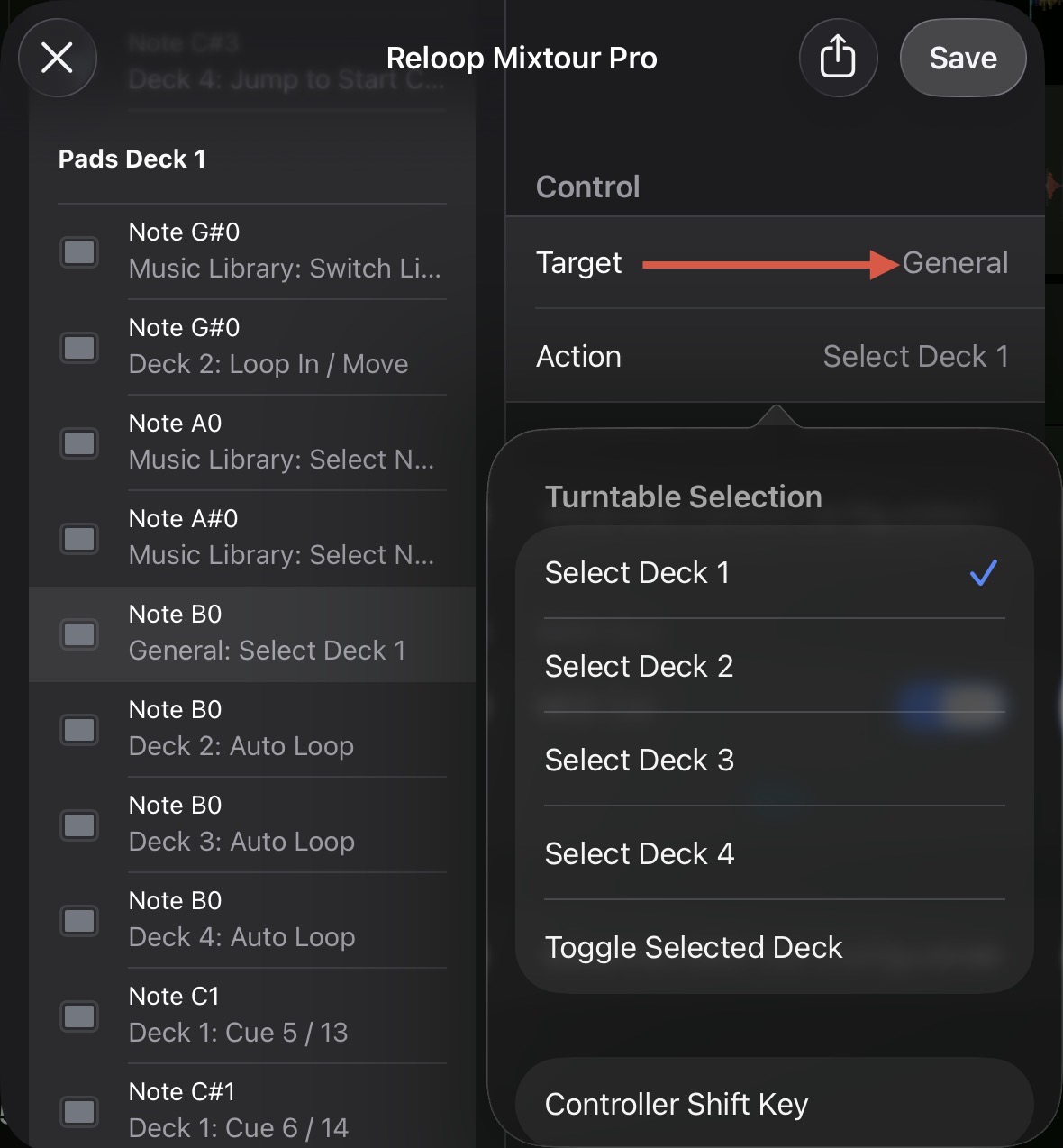

Firt custom map is to use shift encoder to control the tempo. I mapped it to the active deck, but it looks like this is not always the playing deck. I can still kind of use it by tweaking sync mode to get it working if it’s not responding as I like, but not optimal. Any tips?
1 - Yes, I would love a pick up mode for this as well!
2 - Ran into this as well, I set up the cue buttons to also select the active track 1 or 2 so I can press one of those again before changing the tempo. They still function just fine as cue buttons. There’s a suggestion to implement global tempo that would eliminate this, worth a search and upvote if you don;t mind!

@Brainbox for this, you could map buttons for Select Deck 1, 2, 3, 4 so you have precise control over the Active Deck control.
