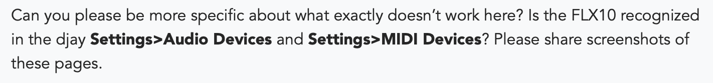

Can you please be more specific about what exactly doesn’t work here? Is the FLX10 recognized in the djay Settings>Audio Devices and Settings>MIDI Devices? Please share screenshots of these pages.

@Nyxxa-Noir , In the meantime, can you already confirm this question by @Slak_Jaw , as anyone helping you will need to know this first :
Do I correctly understand that :
  • Your FLX-10 doesn’t appear at all in the settings>MIDI Devices page at first.
  • Your FLX-10 does appear in the settings>MIDI Devices page, once you have first initiated a connection with Recordbox.
Thank you.
