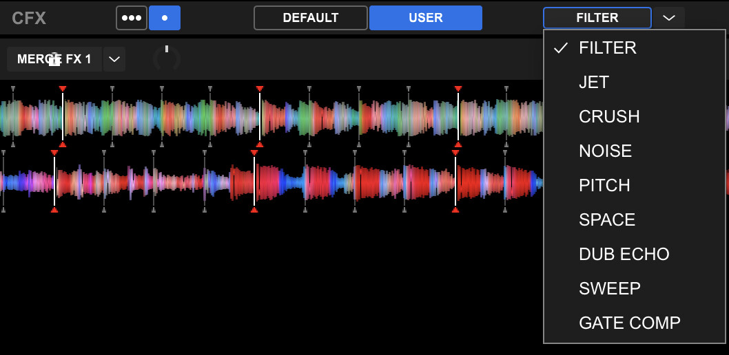

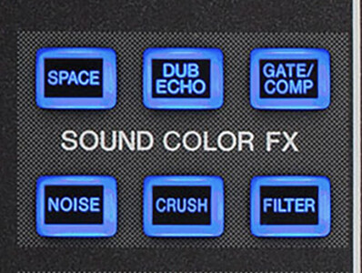

I’m using a DDJ-FLX6-GT and I really like the way the Sound Color FX (CFX) work in Rekordbox. I can use the filter knob to control different Sound Color FX (not just filter), such as the ones shown in the screenshot I attached.

Hi @n421m, currently this is not really possible in djay. The Filter knob in djay does not have an On/Off toggle - it’s always On except when in the center position. You could potentially add FX on top of the Filter, but not instead of the Filter.
For example, you could duplicate the existing Filter knob mapping to also control FX1 Parameter, then map one of the Sound Color FX buttons to turn FX1 ON another button to turn FX2 ON and a third button to turn FX3 ON. This would result in the Filter and FX1 being applied at the same time when you press the Sound Color FX button.
