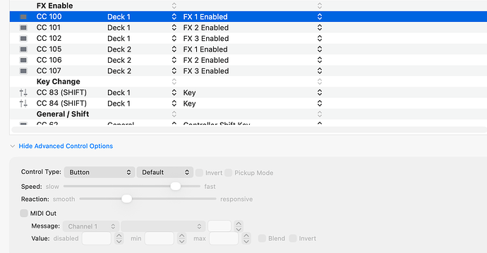

Everything maps perfectly DURING a Djay session however FX 1/2/3 Enable will simply not function work after Djay is restarted. The mapping is still there, but button is completely dead.
Changing the control type (during a session) will allow the button to function normally again until Djay is restarted then it goes completely dead again.
If I set the control type to “Hold“ it will work correctly on restart (but I need it to latch!).
The same controller button can be mapped to any other DJay functions without issue it appears to only affect FX Enable functionality.

Yes I have tried mapping to different buttons, and can successfully map those same hardware buttons without Issues to other functions e.g. Autoloop/Play/Cue/Instant FX etc..
SINCO SMC-Mixer-Master.djayMidiMapping (18.4 KB)
FX Enable is the only function that will not work whatsoever after restarting Djay.

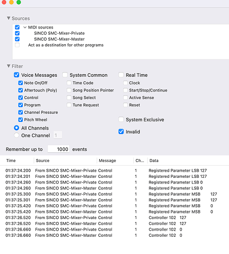

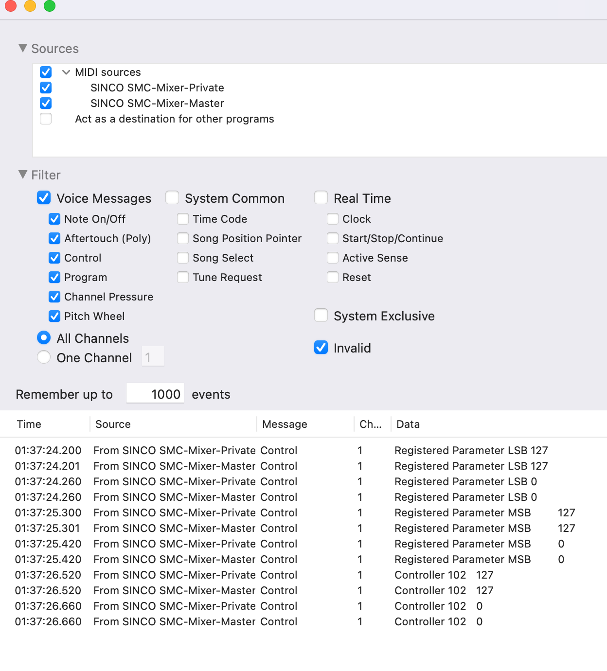

Checked what midi data was being send versus my Mixtour with midi monitor and I found the problem.

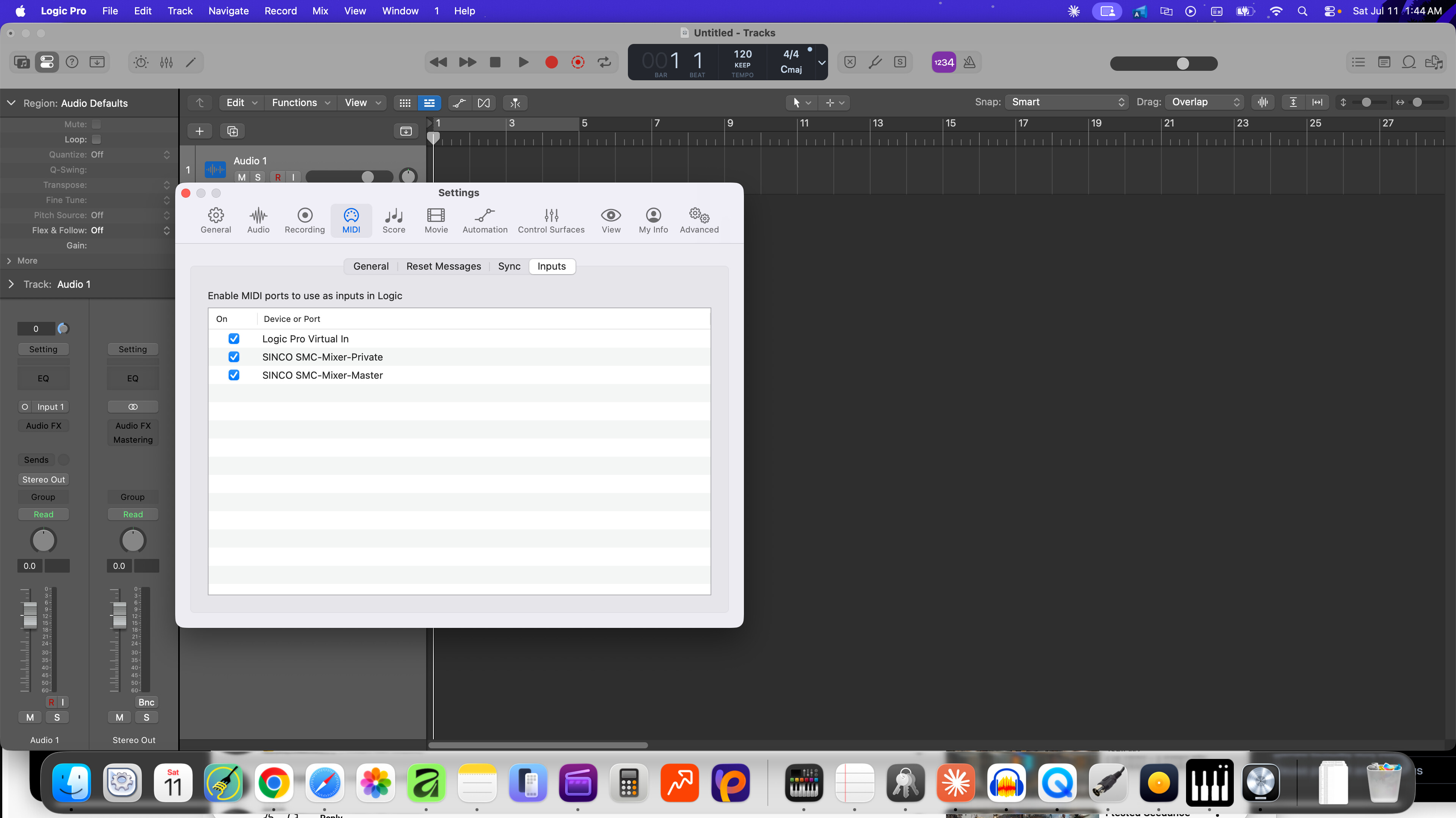

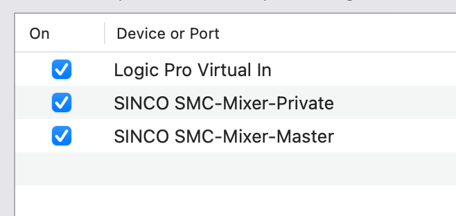

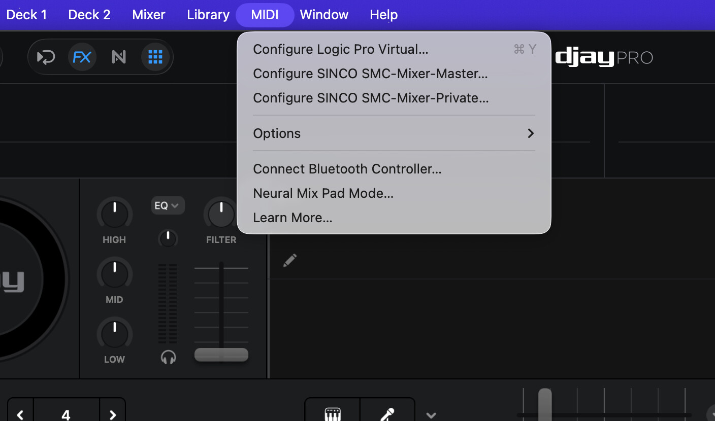

The controller is duplicating the data it sends (Control Surface & User Config) when connected via USB.
In Logic or Ableton you can manually select which input to use, but thats not an option in Djay.
Everything is working fine in Bluetooth mode, so I guess thats how I’ll be connecting from now on.
Thanks for the nudge in the right direction.
