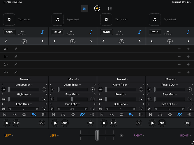

Hi again @Carlos_Alexandre_Cam, this is what it looks like on my iPad with iOS 26.0.1 and djay 5.5.
