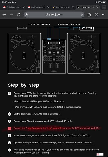

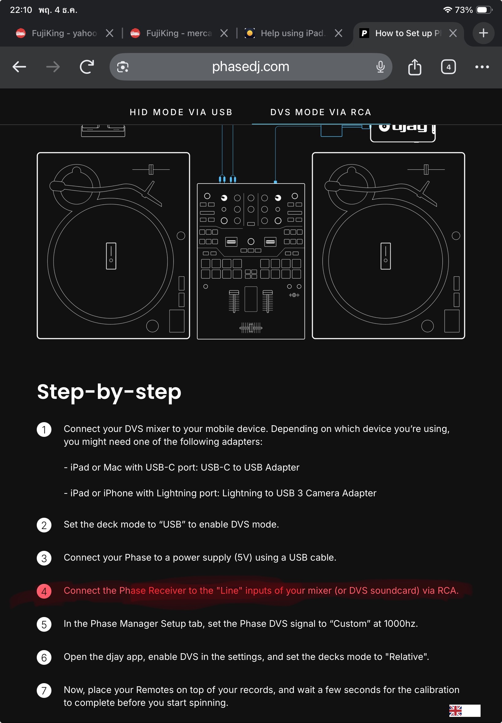

@basskaa thank you for the post. I got it working before I saw your post, and here is what I did to fix it.
Update — I Got It Working (Pioneer DJM-S7 + iPad Pro M3 + Phase + djay)
Just wanted to follow up with the solution in case it helps anyone else running into the same issue.
I was finally able to get everything working smoothly, and the latency + scratching now feel excellent. Here’s exactly what I did:
  1. Change S7 Inputs from Phono to Line
I connected the DJM-S7 to my laptop first and switched both channel outputs in the Setting Utility app for the s7 on my Mac from Phono → Line in the S7 settings.
They were defaulted to Phono, which causes issues with Phase/DVS on iPad.
After changing it once, the mixer has kept the setting even after power cycles, but I’m not 100% sure this persists for everyone.
  1. Update Phase Firmware + Change to Custom Mode
I updated my Phase remotes/base to the latest firmware.
Then I switched Phase from Serato mode → Custom mode and set the signal to 1000 Hz (1 kHz).
  1. Connect Phase RCAs to Line Inputs
I plugged the RCAs from the Phase base into the Line inputs on the S7—NOT the phono inputs.
  1. Set the S7 Input Selector to PC A
On the mixer I set both channels (A and B) to PC A.
  1. Calibrate DVS Inside djay
Once connected to the iPad Pro M3, I went into djay → Settings → DVS and calibrated each Phase deck.
Calibration worked instantly with the 1 kHz tone.
  1. Change Deck Mode in djay
For each deck in djay, I switched:
Internal → Relative
This enabled full physical control with Phase—scratching, cueing, everything.
Result
Everything is working incredibly well now. Latency is excellent, tracking is tight, scratching feels natural, and overall it’s a very solid setup.
Hopefully this helps someone else who’s trying to run:
iPad Pro (M3) + djay + DJM-S7 + Phase (1 kHz custom mode).
