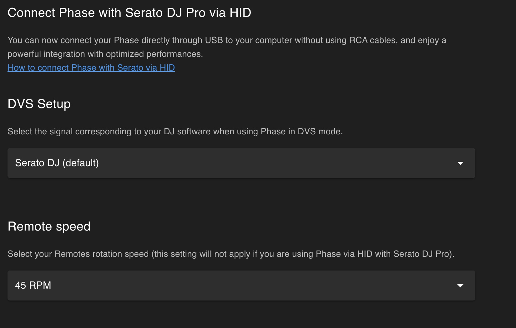

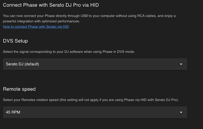

  2. I’m not able to set up the right RPM for Phase in Djay Pro. My Phase is setup to spin at 45 RPM
    But when I connect it to my DJay PRO I have to set the speed on the turntables to 33 RPM otherwise the BPM of the songs are increased. To put it simply, it works at 33RPM as it should at 45 RPM.
    When I connect Phase to Serato it works properly at 45 RPM.
    I’m reporting it just because it’s a little bit weird and It is not a big deal and I can live happily with it as it is but if it can be fixed it would be even better, I’m not experienced as a turntablist and the lower RPM affect my scratching skill a little bit. Maybe I’m missing a setting somewhere but I’m digging into this for weeks now and if I’m wrong I’ll still be happy so thank you so much if you see something I’m not doing correctly.

Regarding your second issue, djay currently only supports 33 RPM.

Regarding your second issue, as I stated above already, djay currently does not support 45 RPM - only 33 RPM is supported.

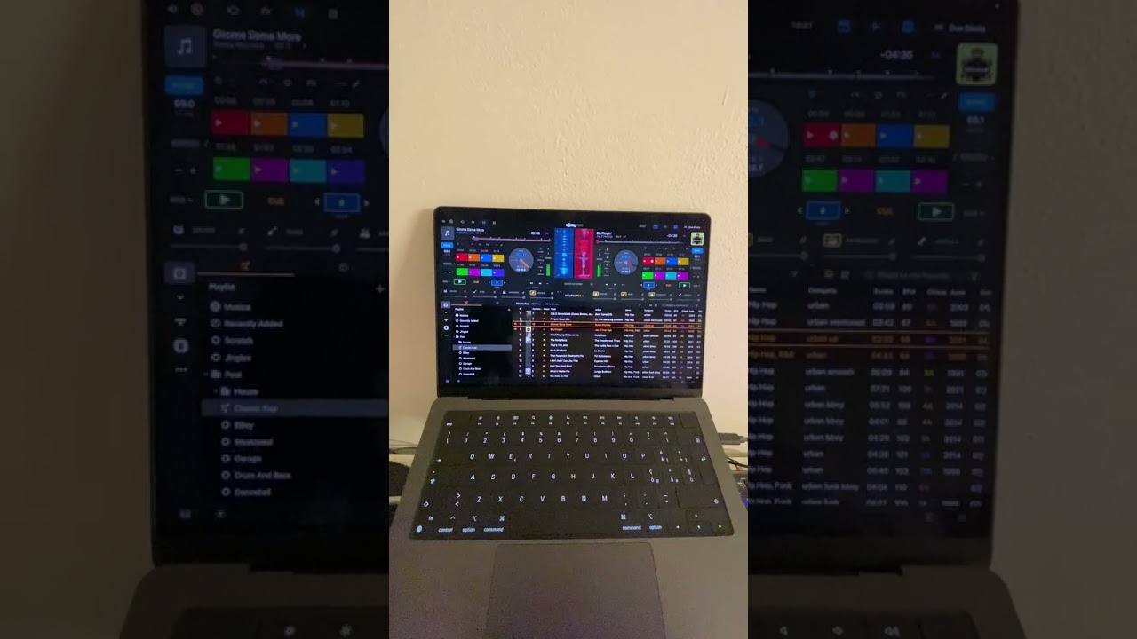

Hello @Slak_Jaw I’ve tried again.
I’m sorry unfortunately it didn’t work.
I’ve made the video to show what I’m doing.
I don’t know if I’m doing something wrong but to me I’ve followed your sequence. Explanation ongoing is not the best but it’s really not easy to record a video, explain and also doing stuff at the same time if you’re not accustomed to it, sorry about that but should still be clear.
Best

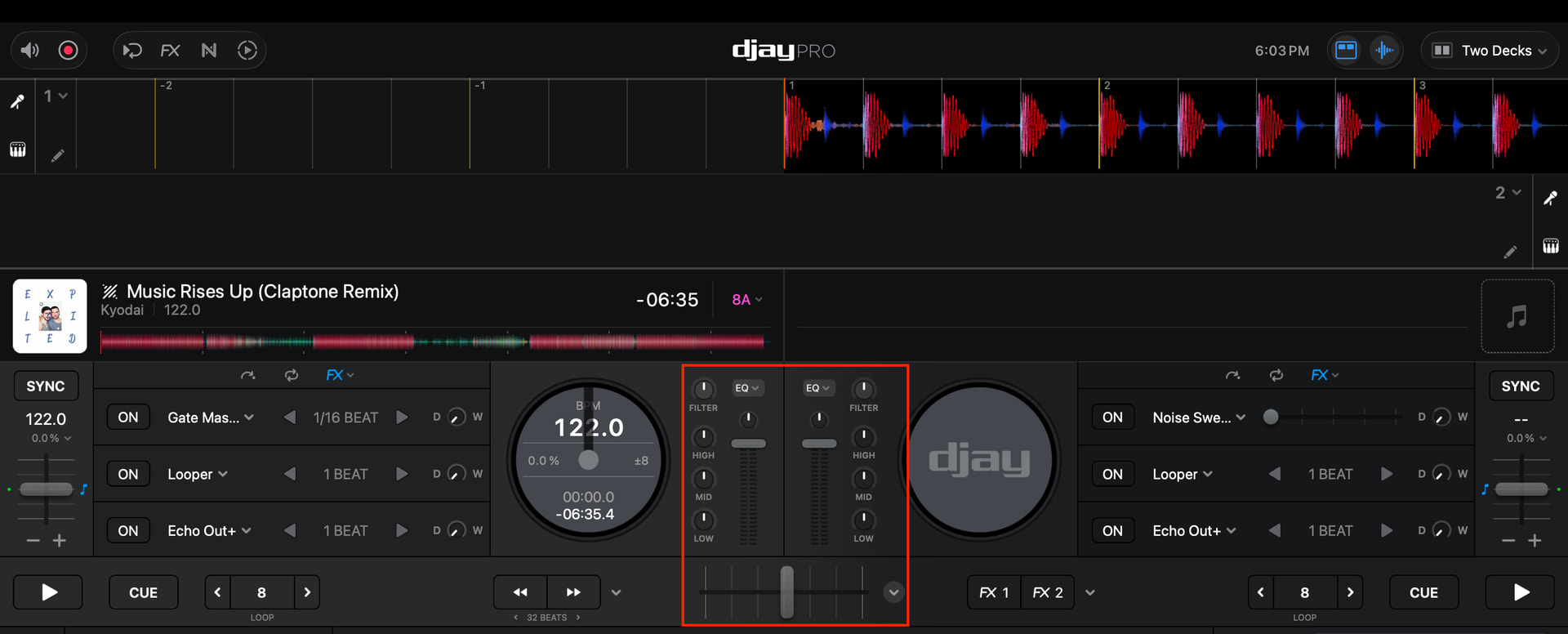

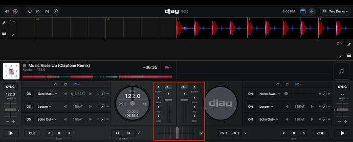

Hi @Francecorre, can you please do a screen recording instead and make sure that the mixer section of djay is visible? Also, can you change the tempo with tempo faders instead of with nudging?
The DJ mixer is not going to be visible even if I show the section as the Reloop Elite is working as an external mixer so you won’t be able to see the cross fader. Volume fader were all up all the time.
I already tried to do the test using tempo faders of the turntables and it was happening the same, I ended up recording the video nudging instead of using tempo faders just for conveniency but the behavior was the same.
Let me know if I still need to record the video or if the above additional information is enough for you.
Understood. Please capture a screen recording to compliment your previous video. Thanks!

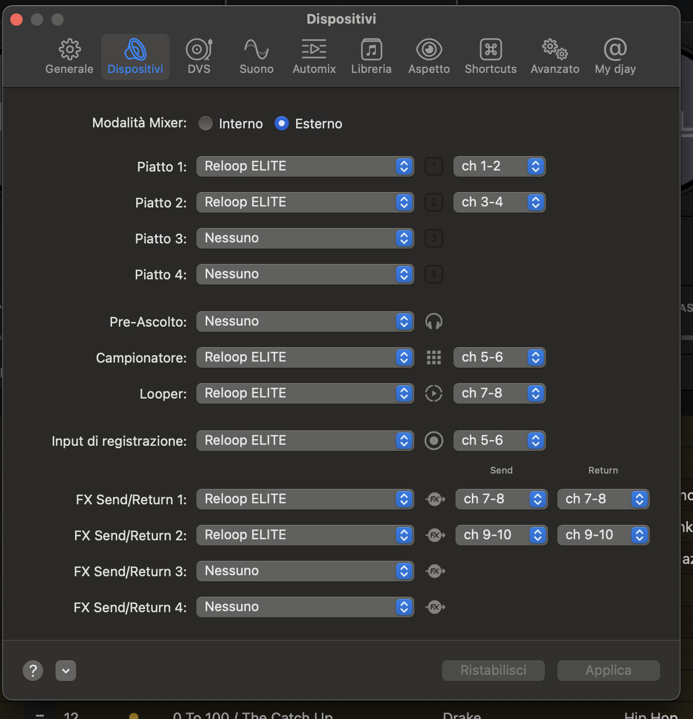

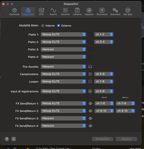

  3. With your DJ hardware connected to your Mac, please share a screenshot of your djay Settings…>Devices.

  3. Here it is
