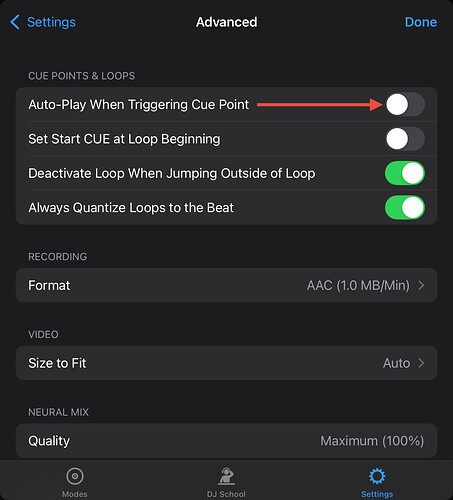

Hi @oleander, please check your Advanced Settings and make sure Auto-Play When Triggering Cue Point is disabled. This will make it so you have to hold the cue point for it to continue playing.
Also, please note that this behaviour only applies when the track is paused. If the track is playing, pressing the cue point will always result in it continuing to play upon release, regardless of this setting.

In the settings, you can specify that a jump to a cue point always results in the song being played from this point.
