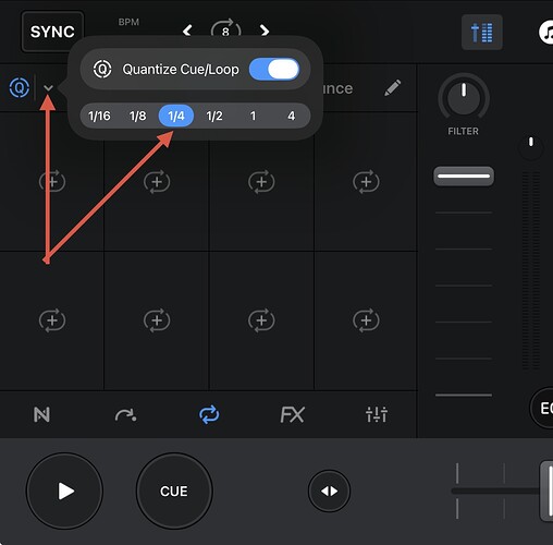

  1. Please test with your Quantize turned Off or set below 1.
  2. If #1 above doesn’t help, please try testing with Keylock Off on both decks.
