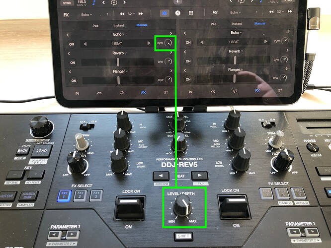

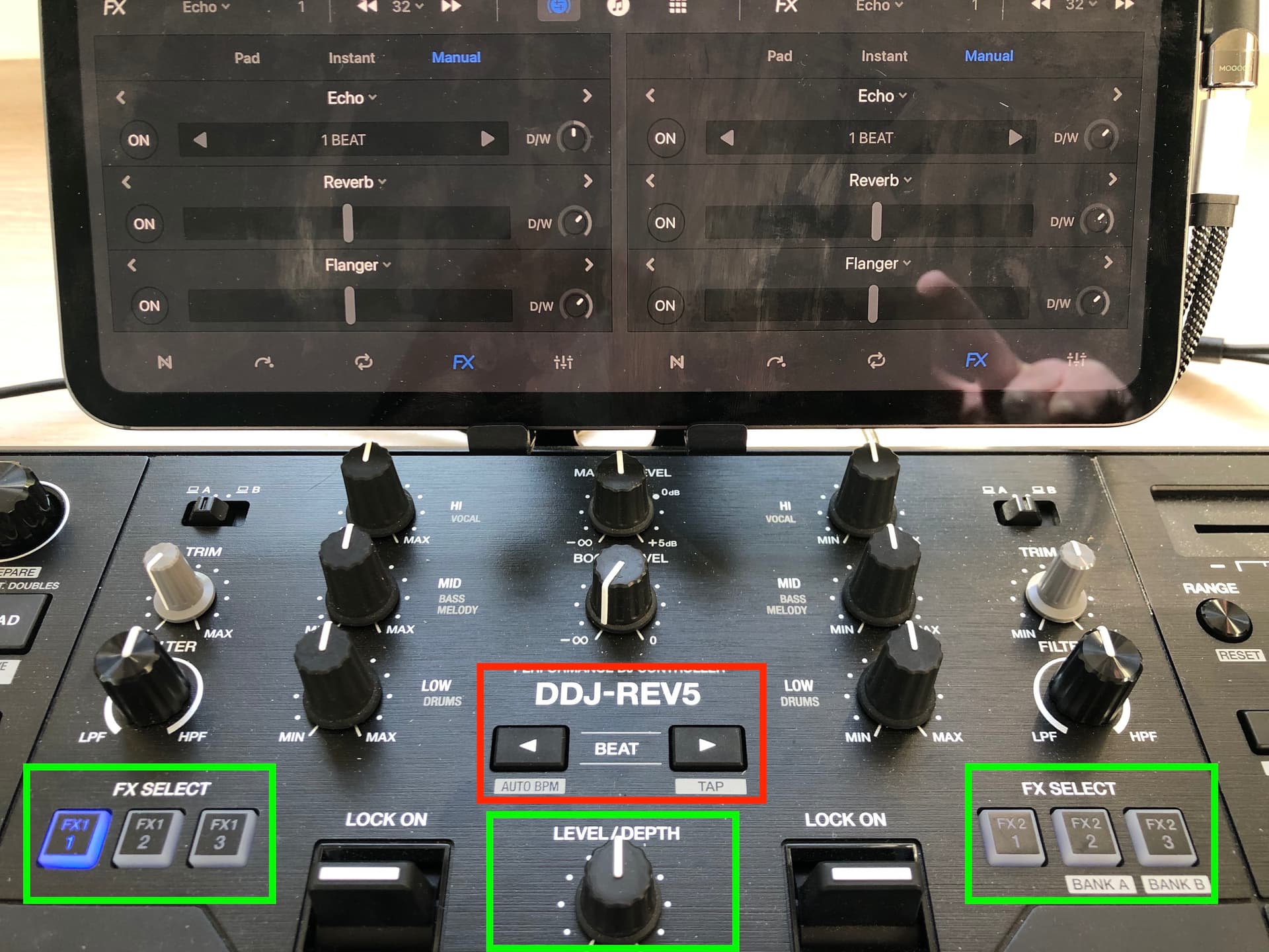

So, On the REV5,
  • There are 3 FX choices on each side.
  • There is always one FX “selected” for changes in parameters (in this case FX1 on the left side).
  • The “Level/Depth” knob will change the Level/Depth of the selected FX, as it should.
  • But the parameter buttons (the red area on the picture) will change all three FX parameters at once. And this is not as expected.
Picture one : FX1 is the currently selected FX.

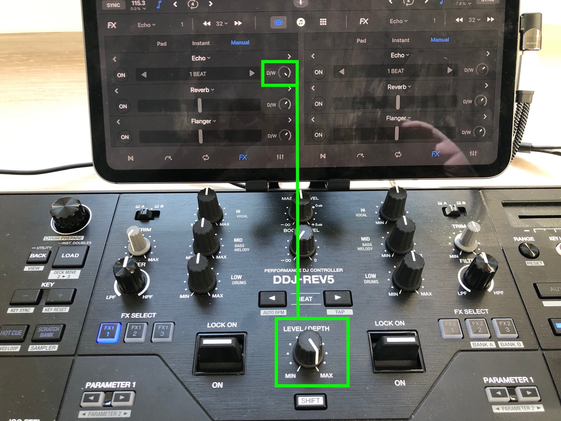

Picture two :
I rotate the “Level/Depth” knob to the right : The FX1 Level/Depth moves to the right on the iPad, as it should.

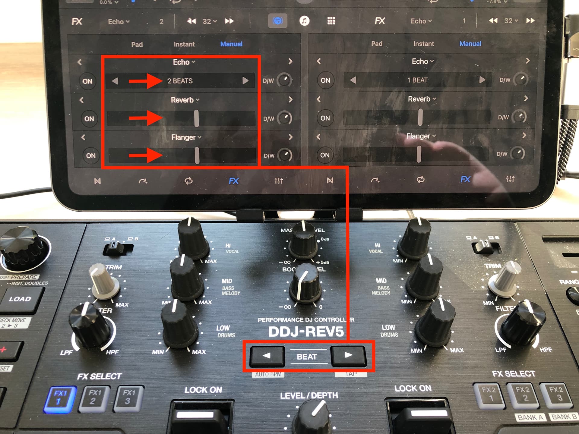

Picture three :
I want to change the FX parameter of FX1, but they move all three at once.
For the example, I am clicking on the right (= increase) button.
So, as we see, they have all three moved to the right.
  • the Level/Depth button is working as expected.
  • But the parameters button are not.

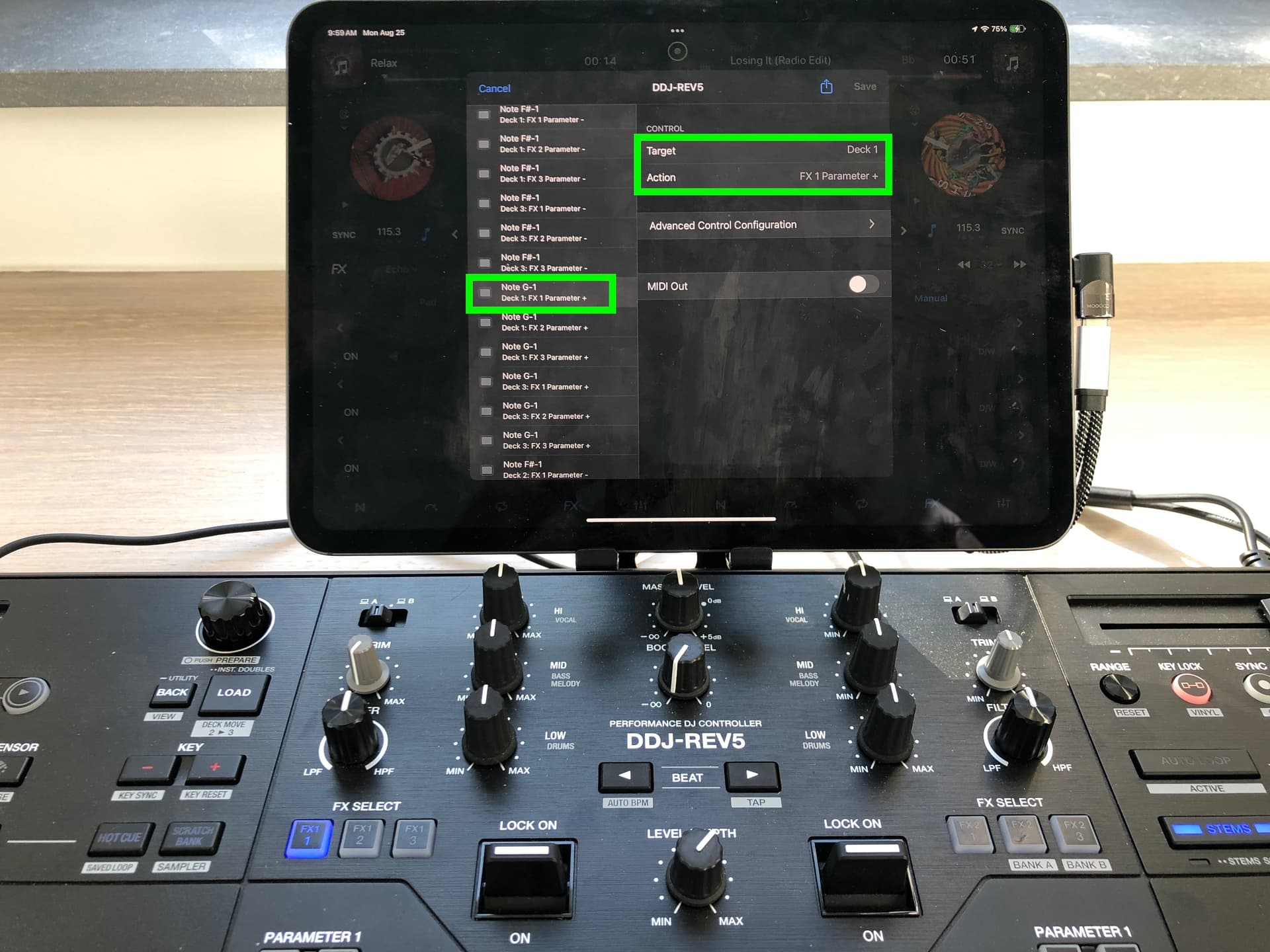

Picture four :
Standard mapping. I haven’t changed anything.
We see Djay has perfectly understood
  • which is the selected parameter (FX1)
  • and the correct action button.
But DJay Pro is still moving all three parameters at once, which it shouldn’t do.

Go into djay folder “On My iPad”, look for your controller “djayMidiMapping” and make a back-up elsewhere. Then you can open with a text editor and look for “turntable1.fx1ParameterValue” identify the midiData integer (your button) and look for “turntable1.fx2ParameterValue and turntable1.fx3ParameterValue” and you will notice that they are duplicated and using the same button and you can delete them. Same for “turntable2”.
Save the file and enjoy.
If something goes wrong you have a back-up file or you can delete and DJAY will restore a default configuration file.
L.E. I noticed that you have buttons to select witch FX to be active, instead of deleting them you can make conditions for those “fxParameterValue” to be active when the Fx parameter is ON.
Something like:
condition
fx2==1
followed by the rest of the code for Fx2ParameterValue
It’s a lot of try and error, because I didn’t find documentation regarding midiMapping, but is doable.
Thank you very much @Gabi0110 .
But, I mean, REV5 is a “Fully Supported Controller”
Djay is handling everything correctly for the Depth knob.
The parameter buttons are following the same logic, but the filter for “Active FX” has probably been forgotten in this latter case :
In other words :
  • The FX parameter knob is OK (applied to selected FX).
  • The FX parameter button in NOK (applied to all FX, not filtered on selected FX).
So, I am just reporting the bug for continuous improvement and quality control of this magnificent software.
I am actually not using these functionalities myself.
Good catch @Davidv100, the engineering to is looking into a potential fix for this which should be included in an upcoming update (likely 5.4.3). Thanks!
Hello @Davidv100, 5.4.3 was released today and should address this issue. Thanks!
