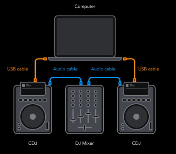

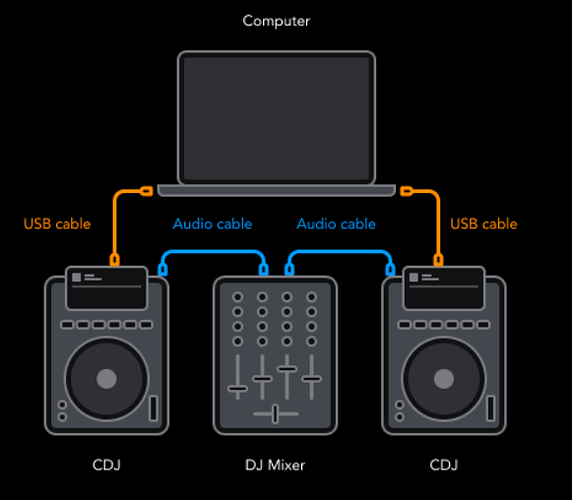

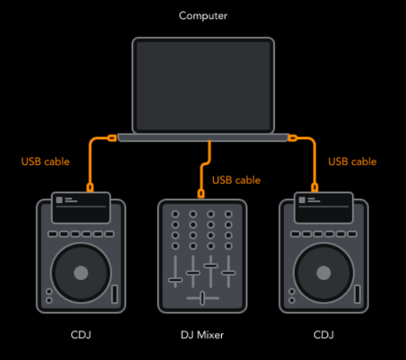

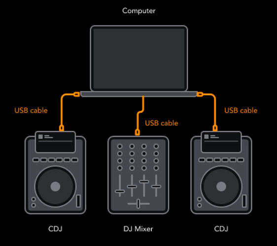

Just now, I tried to run the CDJ and Mixer using Only USB cable connected to laptop but still the waveform won’t show
and I also tried route the audio cable from CDJ to Mixer and only Connect USB cable from CDJ to Laptop, yet the waveform still won’t appear

Hi again @OGAS. Thanks for the two videos! This is exactly what I needed, and cleared things up.
  • Good news first: your connection is correct now. Both players show CONTROL MODE with your djay library, track title, BPM, elapsed time and the overview waveform along the bottom — so HID is working properly. The only thing missing is the large/zoomed waveform in the centre of the screen, which stays on the Rekordbox logo. This doesn’t look related to how you’re connected or the track source.
