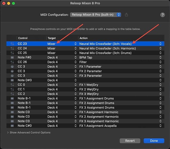

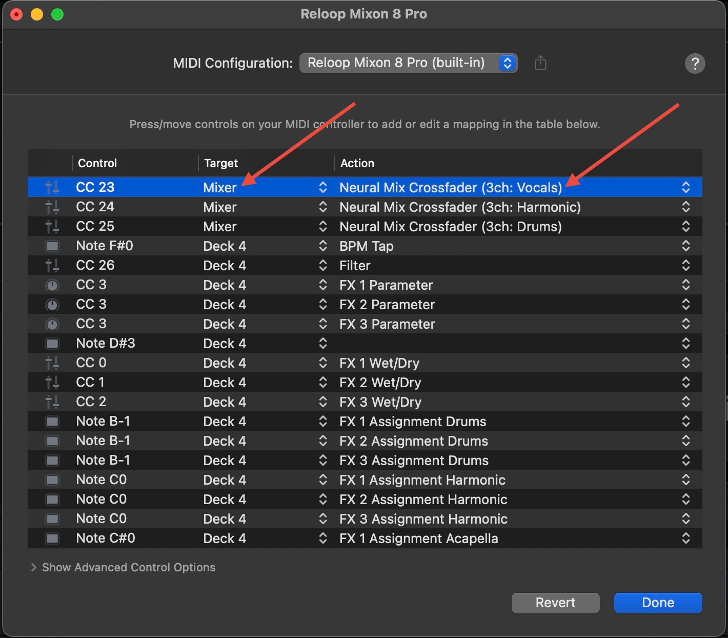

@dj_dubantheM, while in the MIDI Learn tool on macOS:
  1. Rotate the Deck 4 High EQ
  2. Change the Target to Mixer
  3. Set the Action to Neural Mix Crossfader (3ch: Vocals)
  4. Rotate the Deck 4 Mid EQ
  5. Change the Target to Mixer
  6. Set the Action to Neural Mix Crossfader (3ch: Harmonic)
  7. Rotate the Deck 4 Low EQ
  8. Change the Target to Mixer
  9. Set the Action to Neural Mix Crossfader (3ch: Drums)
  10. Save your modified MIDI Mapping.

You’re welcome @dj_dubantheM. Without a video or screenshots from you, it’s hard for me to know what you are doing wrong exactly. This works perfectly on my Mixon 8 Pro. So, perhaps the easiest solution is for me to MIDI Map it for you. Please copy the file below to the Music>djay>MIDI Mappings folder on your Mac. Then inside of djay, select the Reloop Mixon 8 Pro-NM Crossfader MIDI Mapping. I have mapped the Deck 4 Gain and EQs to control all 4 Neural Mix Crossfaders.
Reloop Mixon 8 Pro-NM Crossfader.djayMidiMapping (292.9 KB)
o wow ! it worked! thank u so much! i was trying all these combinations and just couldn’t get it situated. but your mapping worked and im really grateful for it. what the hell was i doing wrong?
