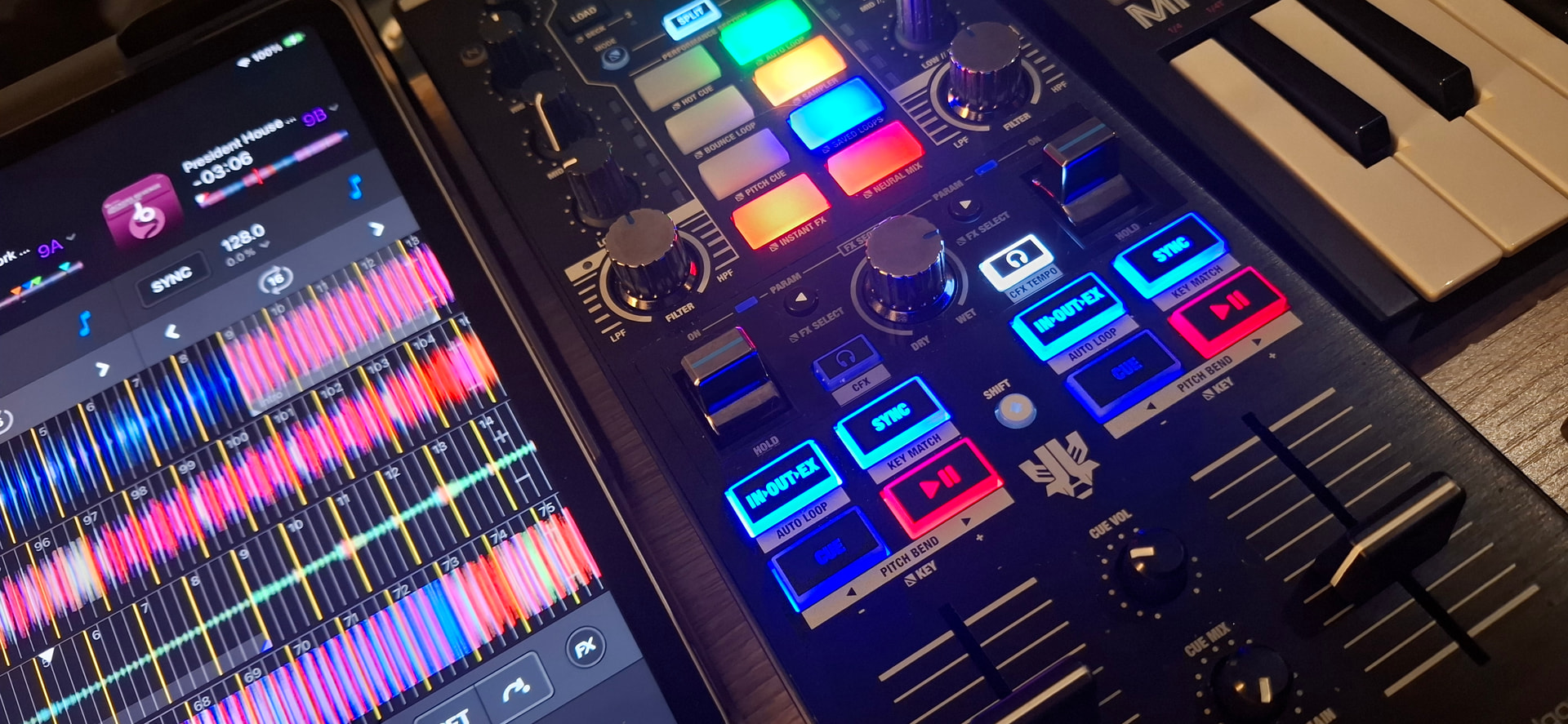

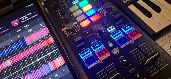

I remapped transport buttons to turn red if on deck 3 or 4. Instant deck engagement with binary red, blue, left or right.

Decks 1 and 2 retain the two physical volume faders. The two gain rotaries become direct line-volume controls for Decks 3 and 4. But the part that’s made the biggest difference for me is what happens next.
Touch the volume control for the deck you want, and the controller follows you.
The two Play buttons then work as shared transport controls, with a very simple binary visual system:
BLUE = Decks 1/2
RED = Decks 3/4
Position tells you the side. Colour tells you the deck bank.
So:
Left + Blue = Deck 1
Right + Blue = Deck 2
Left + Red = Deck 3
Right + Red = Deck 4
If I touch the Deck 1 fader, the left Play button goes blue and Play controls Deck 1. Touch the Deck 3 rotary, the same Play button goes red and now controls Deck 3.
Same principle on the right for Decks 2 and 4.
