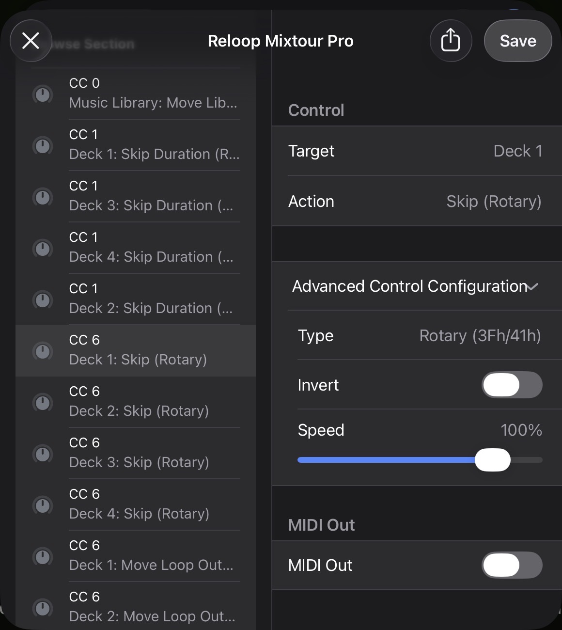

The (built-in) MIDI mapping doesn’t have any controls for Beat Jump/Skip. I also use this function a lot, so I customized my MIDI mapping. I use the Deck 1 MODE+Browse Knob for Deck 1 Skip and the Deck 2 MODE+Browse Knob for Deck 2 Skip. You will have to use the onscreen controls to set the Skip Size or custom map that to some other controls on the Mixtour Pro.

Not sure if this is worth another thread, but curious how else you customize your mixtour pro mappings. This best jump one is perfect and adding it right away. I’m still struggling with changing which effect is active without using the laptop for example.
