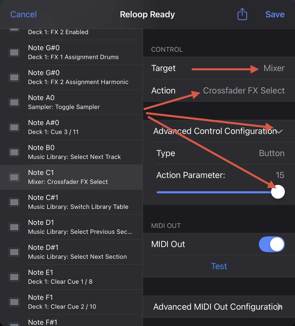

  3. By “transition FX” do you mean the Crossfader FX? If so, then yes you can MIDI map specific FX selections by expanding the Advanced Control Configuration section and setting the Action Parameter: value from 0-15. Each number represents a different CFX type. Below is a screenshot on iPad, but it will work similar on macOS.
