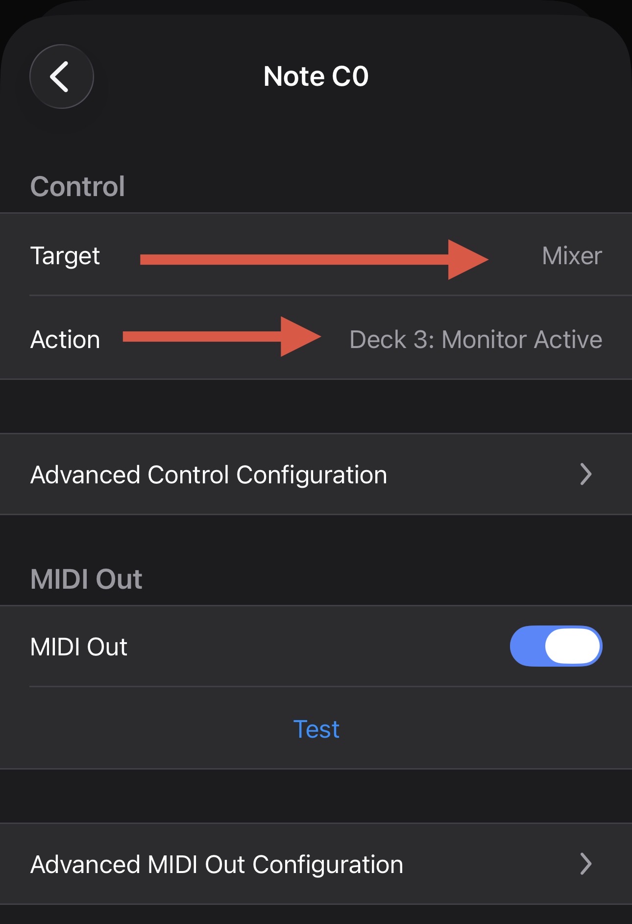

so i mapped everything now i dont know to be able to hear the cue for deck 3 and 4 via my rane cue what would the sound mapping look like for that . i can hear the master of it
@CrossFade1200, try mapping the headphone cue buttons on the MixTrack Go to Deck 3: Monitor Active and Deck 4: Monitor Active
