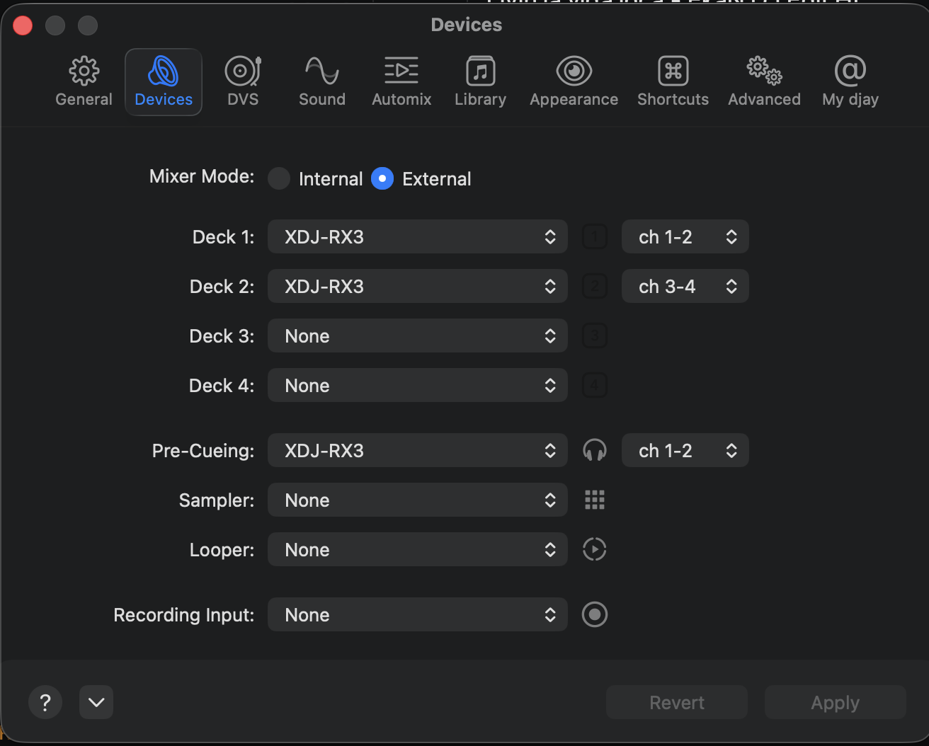

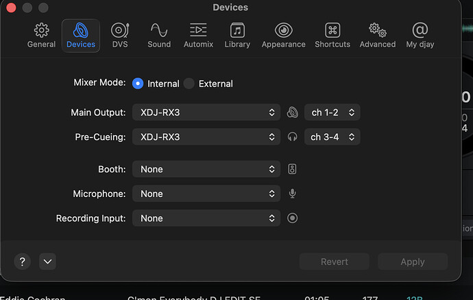

But I am messing around with the internal/external mixer mode settings in djay pro.
I have tried all different options, but no steady result. At the moment I am hearing the song from deck 2 on both faders of the RX3. And pre-cueing through headphones in the RX3 is not working.
What are the settings I need to apply?
Jan
Delete any midi mappings you created for RX3 and use the default.
Reset audio settings to default (Click drop-down arrow on Left bottom corner of screenshot).
Should work fine in one of those modes (I would try internal mixer first).
Hi @Jan_Van_den_Bossche1, please also note that the RX3 is an External Mixer Mode Device and must be used in External Mode not Internal Mode.
Thanks for the help @Armigo
