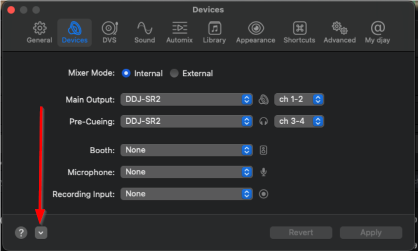

Hi @Delios, sorry to hear you’re experiencing this issue.

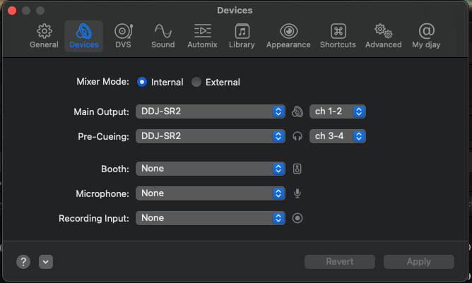

  1. With your DDJ-SR2 connected to your Mac, please navigate to the djay Settings>Devices, expand the pop-up menu at the bottom left and select Reset to Defaults.

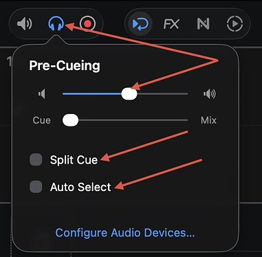

  2. Please also check the Headphones section near the top left of your screen and share a screenshot of this drop-down menu.
Hi @Slak_Jaw :smiley:
You’re a LIFESAVER! Thank-you :folded_hands:
The pre-cueing volume was muted within the software :man_facepalming:
