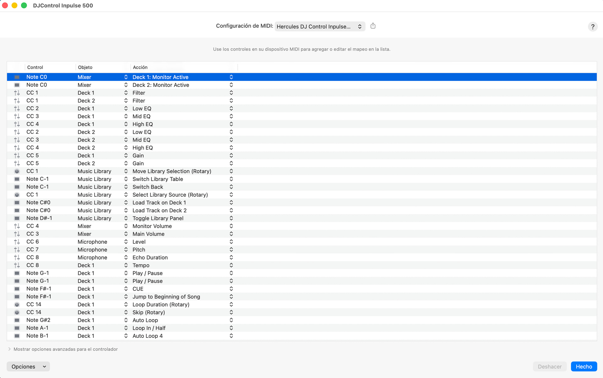

  2. With the controller connected to your Mac, please share screenshots of your djay Settings → Devices page, and MIDI → Configure Impulse 500… page.

Thanks for the details and the screenshot, @jnavarrotf. Your MIDI mapping looks correct — the cue buttons are assigned to Deck 1: Monitor Active and Deck 2: Monitor Active, so this isn’t a mapping problem. Since it works on your iPad with the same controller, it points to the audio routing on the Mac side.
  1. On the Mac, open Settings > Devices and click Reset to Defaults — this restores djay’s correct routing for your controller.
  2. Confirm Pre-cueing is set to the Inpulse 500 (on a different channel pair than Main Output), then click Apply.
  3. Click the headphones icon in the toolbar and make sure Cue/Mix isn’t turned fully toward the main mix. [screenshot: pre-cueing panel]
