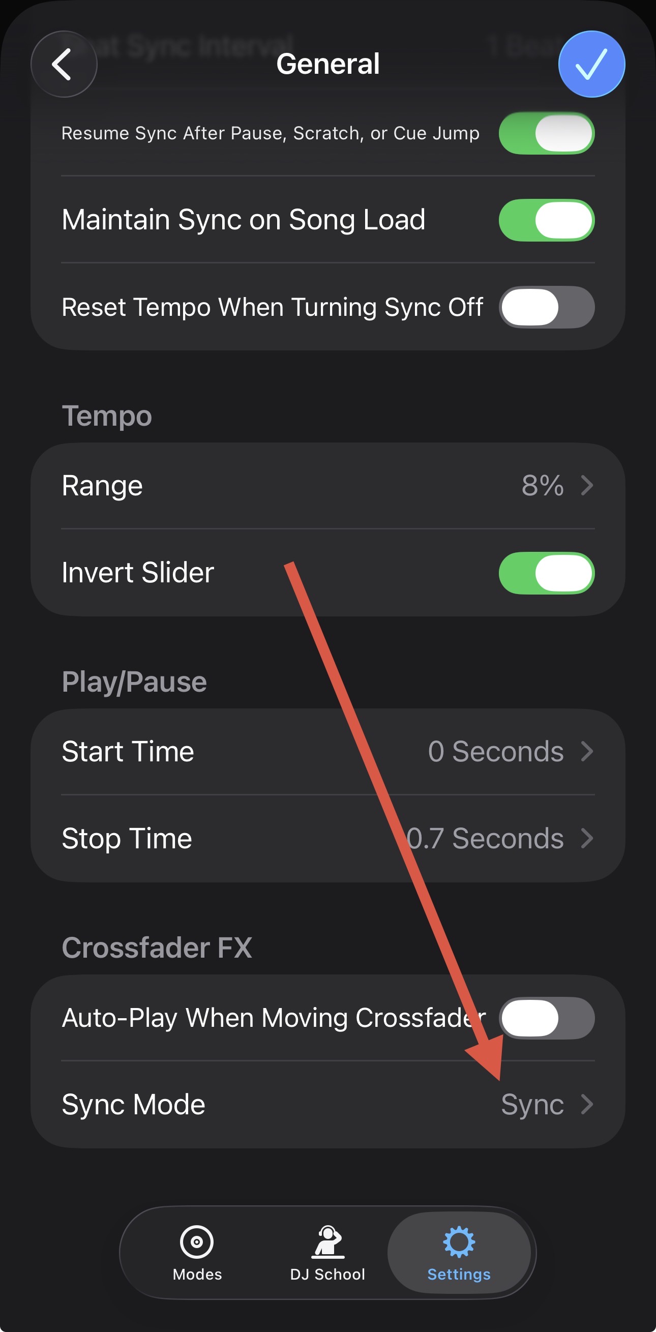

Thanks for the additional info @theoryhater0. Yes, currently Keylock is required when using Crossfader FX and Automix with Tempo Blend. I will pass your suggestion onto our dev team though. Also, I have adjusted the title of this topic for clarity. Thanks.
EDIT: In the meantime, you can disable Tempo Blend in the djay Settings>General, by setting the Sync Mode to Sync or Off.

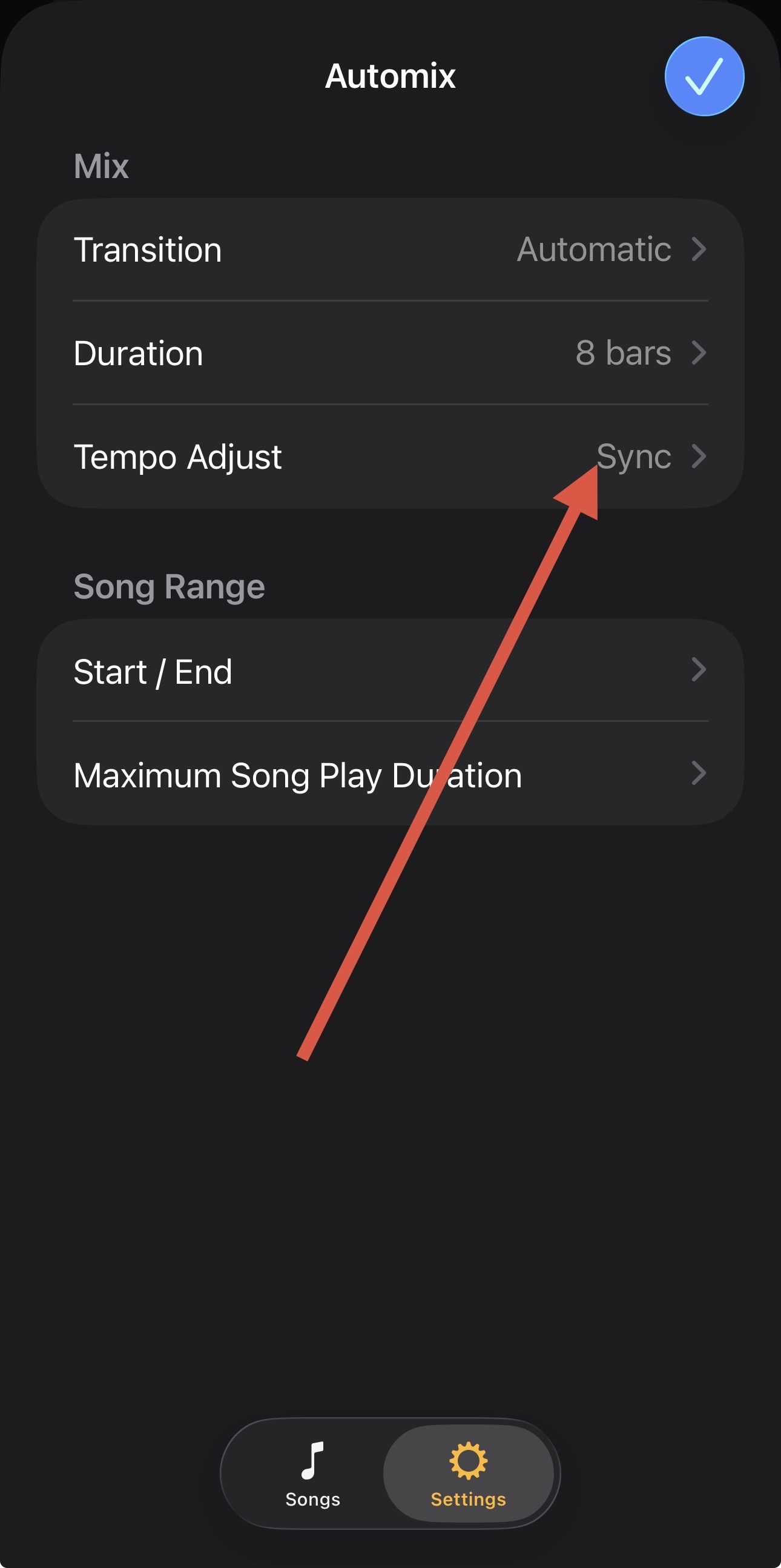

Also, if you are using Automix, you can disable Tempo Blend here in the Tempo Adjust Settings:
