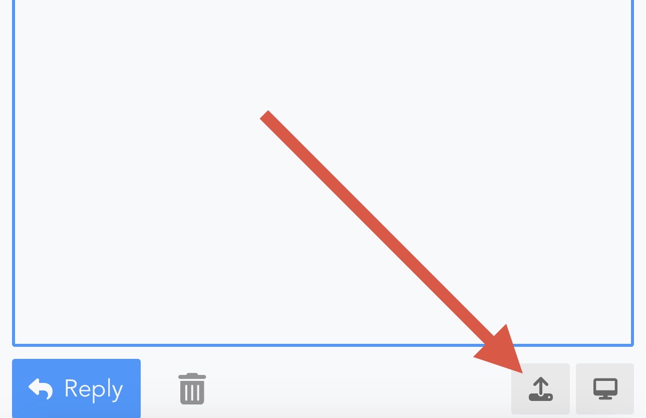

How do I upload video?
Hi @Alex_Foreal, simply attach it to your post using the upload icon.

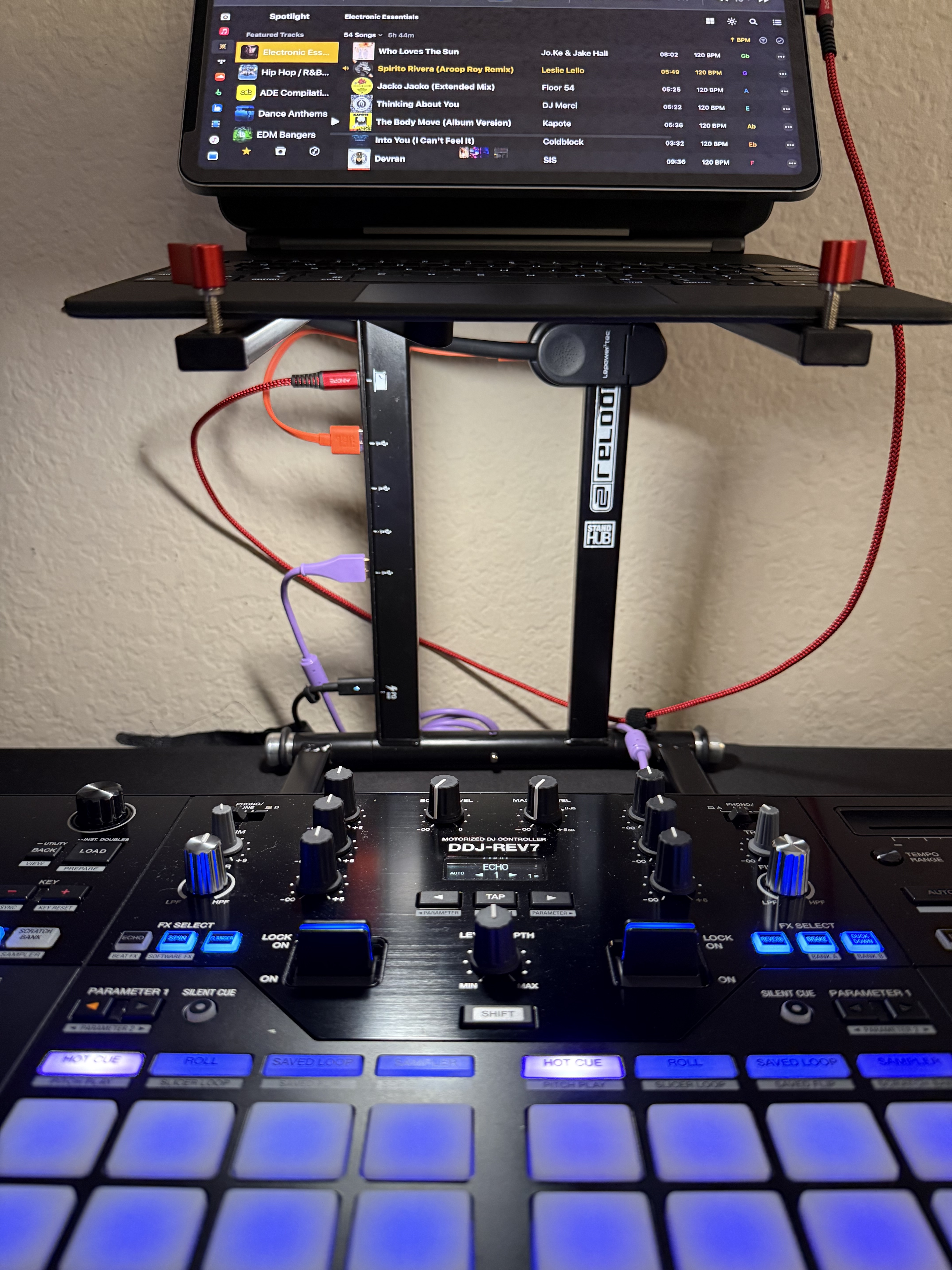

  6. How exactly are you connecting your iPad to the REV7? Are you using any USB Adapters or USB Hubs?
Not using sync , but it does do it using sync as well , does it on every song, Same BPM, using the reloop hub with USB- C to rev 7. Never had an issue till update to 5.5

Can you please try connecting directly to the REV7 without using the Reloop Stand Hub?
Issue does not occur when just using app on iPad , only when Rev7 plugged in. I bypassed Reloop hub and still drifting/ skipping when hitting play on rev7. I tried it with a Numark Mixtrack Platinum FX and it’s fine using with iPad and using reloop hub. So I’m guessing updated 5.5 affected rev7.
