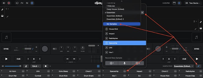

Hi @R_I, I’m guessing you used something like the following to record the 3 samples?
Once your Samples are recorded you need to Edit the Sample Pads for Deck 2 (the 8 pads on the right side), choose the dropdown menu and navigate to your recorded samples in My Samples. Do this for each of the 8 pads on Deck 2 that you want to assign them to.

Yes, I know. That is why you have to edit the right 8 pads like I instructed above so they are playable on the right 8 pads (Deck 2). Then change the pad mode on Deck 2 of the FLX10 to the Sampler Mode.

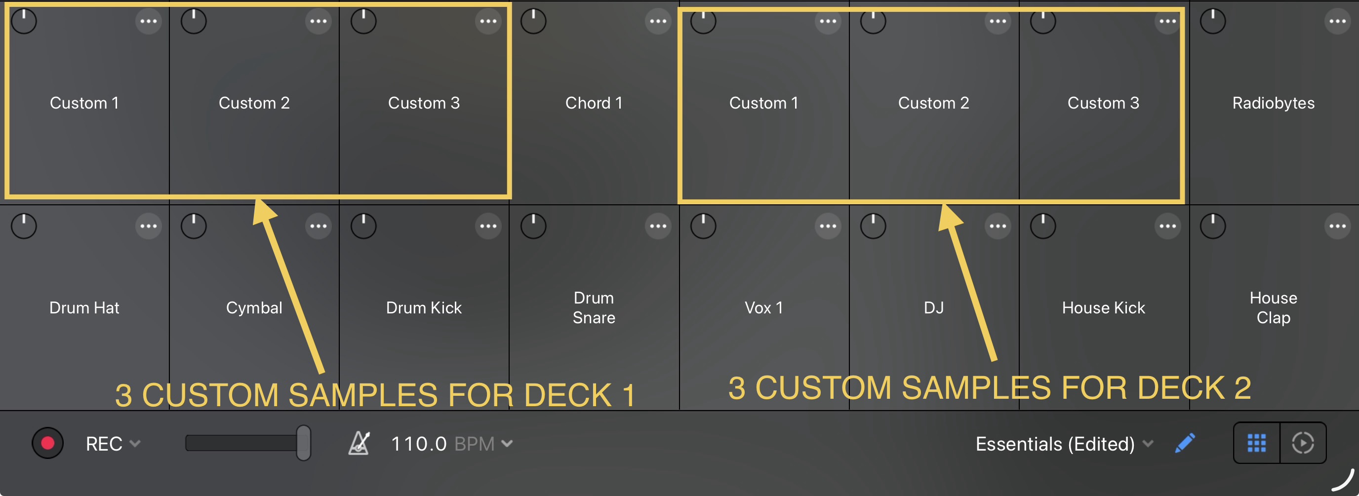

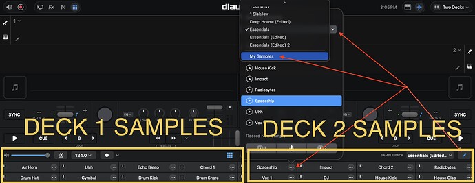

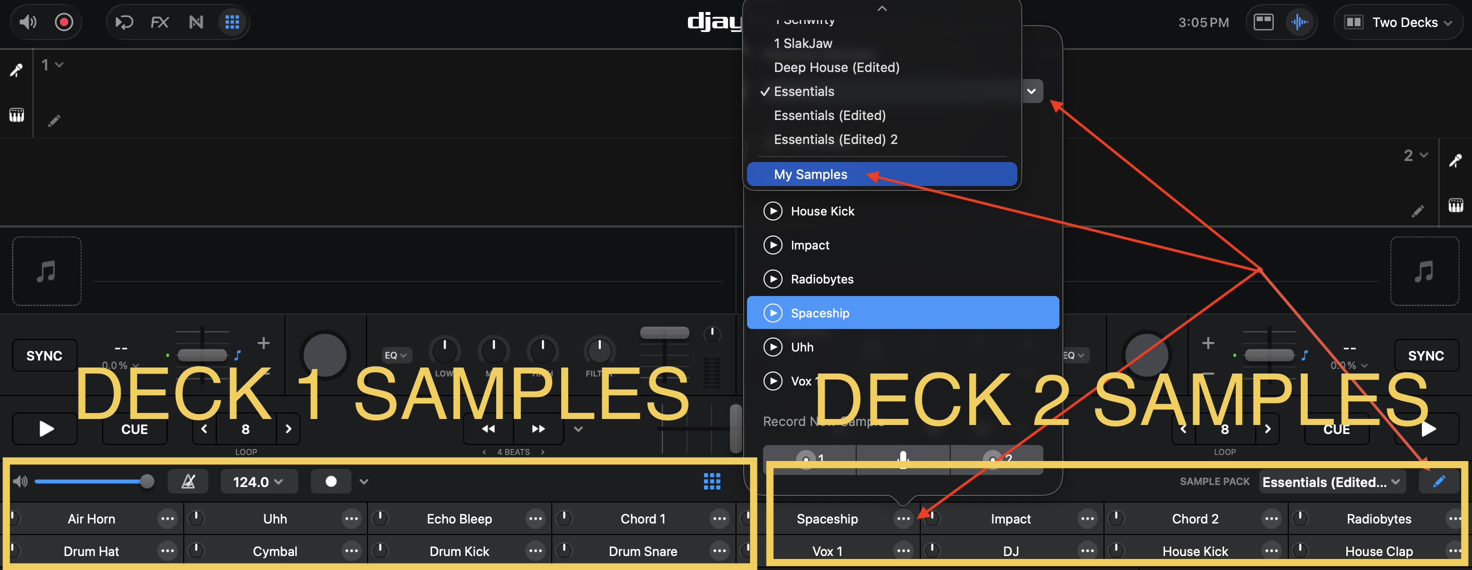

The left 8 samples are for Deck 1. The right 8 pads are for Deck 2. If for example you want your custom samples on Deck 1, Pad 1, Pad 2 and Pad 3 to also play on Deck 2 of your FLX10, you need to load/duplicate them onto Pad 1, 2, and 3 on the right side
Once setup correctly, it should look something like this
