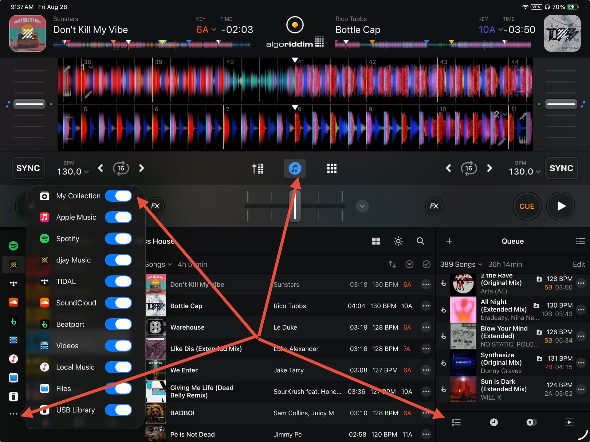

Two things that should cut most of the mid-set hunting:
  1. Build one My Collection playlist per gig and mix the sources in it — Beatport tracks, TIDAL acapellas and local files can all sit in the same playlist. My Collection > dropdown next to the track counter > Add songs > Library. Then you’re not switching sources at all while you play.
  2. Pre-load the acapellas you might reach for into the Queue — tap a track’s three-dot menu > Add to Queue. During the set it’s one tap on the Queue tab instead of a deep dive through TIDAL folders. Adding to Queue | Algoriddim Support
Also worth two minutes of setup: tap Edit in the sources dropdown (top-left of the library browser) and switch off every source you don’t actually use. Shorter list, less to scroll past.
Regarding the iPad — the browser essentially behaves the same. However, you see more rows at once, so there’s less scrolling. Also, on iPad you can see the library and the performance sections at the same time. I hope that helps!
ah yes
on ipad you see that extra queue!
so awesome :slight_smile:
