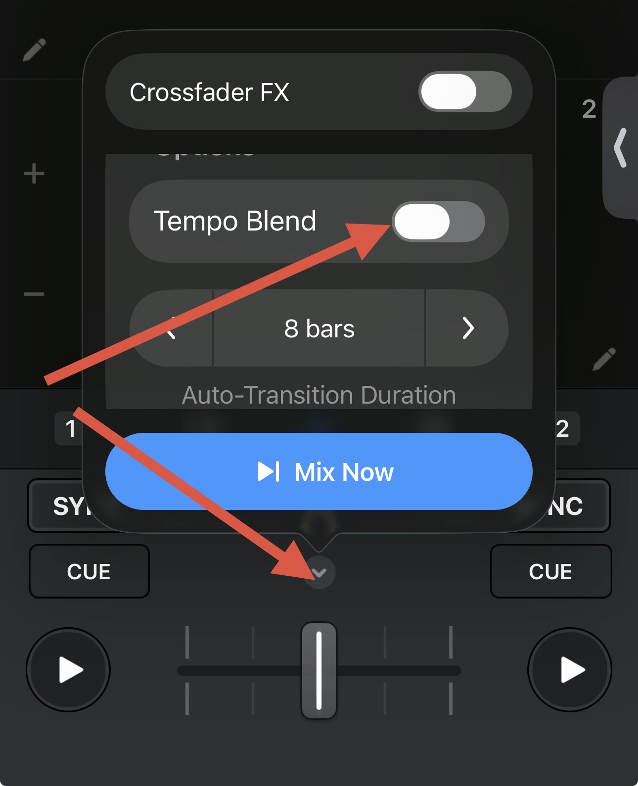

Hi @Paul,

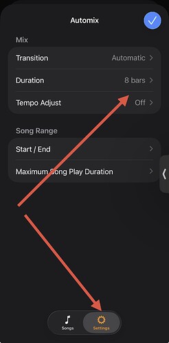

  1. Please make sure Tempo Blend is turned OFF in the CFX menu.
  2. Also, make sure Tempo Adjust is OFF in the Automix Settings.
Turning off Tempo Adjust in the Automix settings seems to have done the trick. Thanks
You’re welcome @Paul
