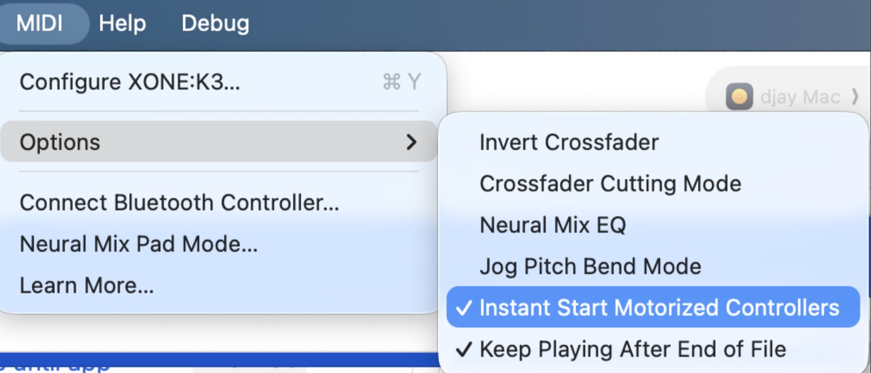

Hi again @Scott1, turns out that our engineering team is already aware of this issue and they’re working on a fix which should be released in an upcoming update (likely 5.6.3).
In the meantime, the workaround is to disable Instant Start Motorized Controllers.

Back to report. Sadly, this did not correct the problem. Thanks for trying! I hope there’s something else maybe they’re working on to fix it. I can only say that it maybe, slightly lessened it. Maybe. Still did it a couple of times in a ten minute period. Thank you again for the efforts!
You’re welcome. Sorry to hear the workaround didn’t help you. As stated above the team is working on a proper fix which should be released in an upcoming update. Thanks.
