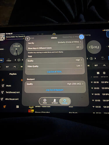

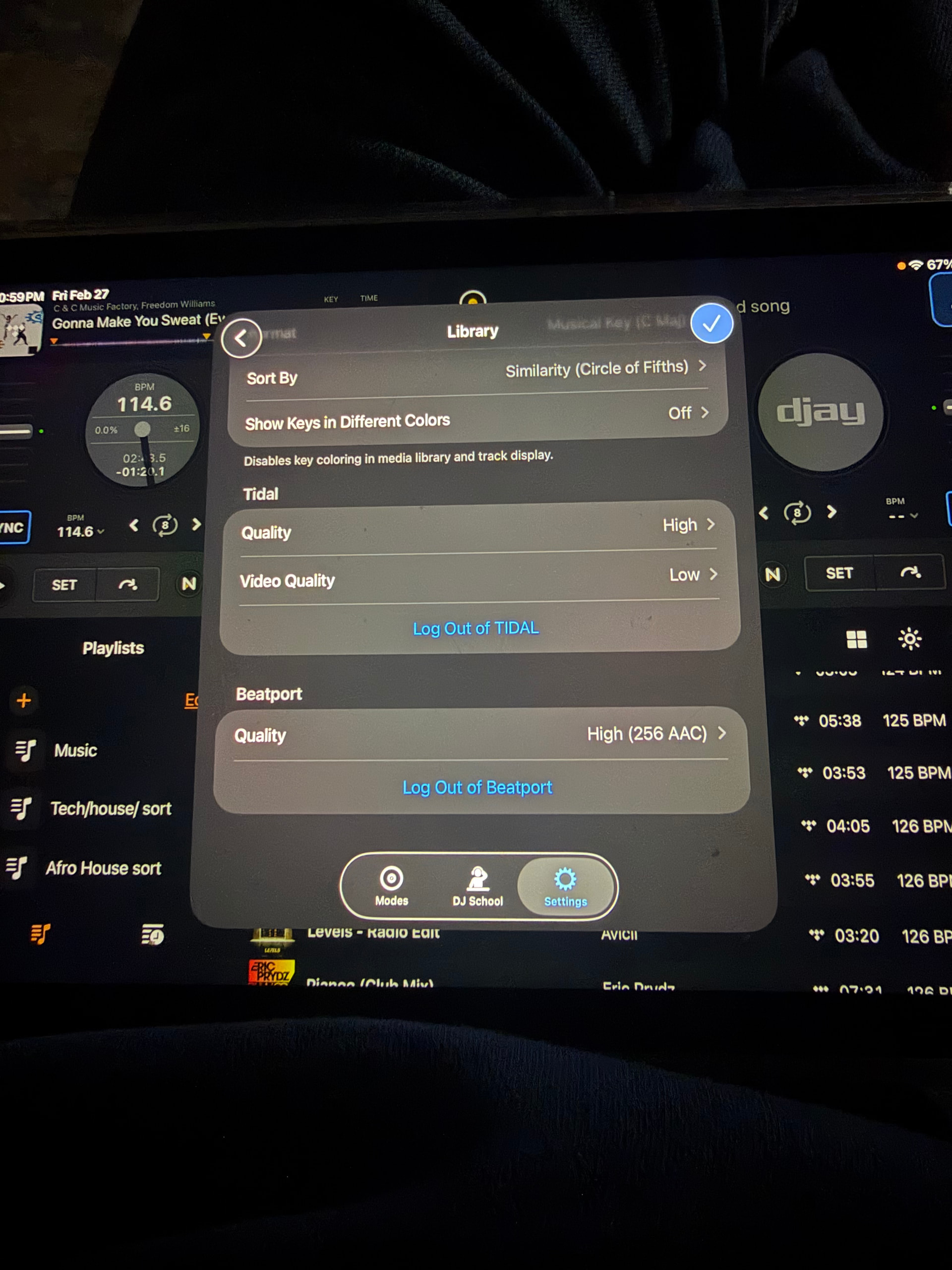

  1. What Streaming Quality are you using in the djay Library Settings?

Try a lower streaming quality setting
Okay, I’ll give it a shot! I have an idea to play some quality music) I’ll pay extra for that! But I’ll test it out!

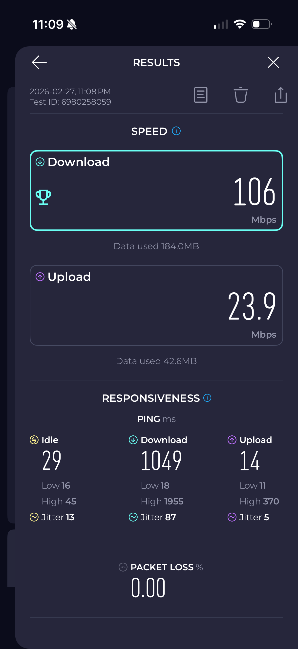

Please also perform a WiFi speed test on your iPad and share a screenshot of the results.
I recommend you use a lower streaming quality setting.
But I’ve never had that) if I lower the quality, it will be noticeable(
