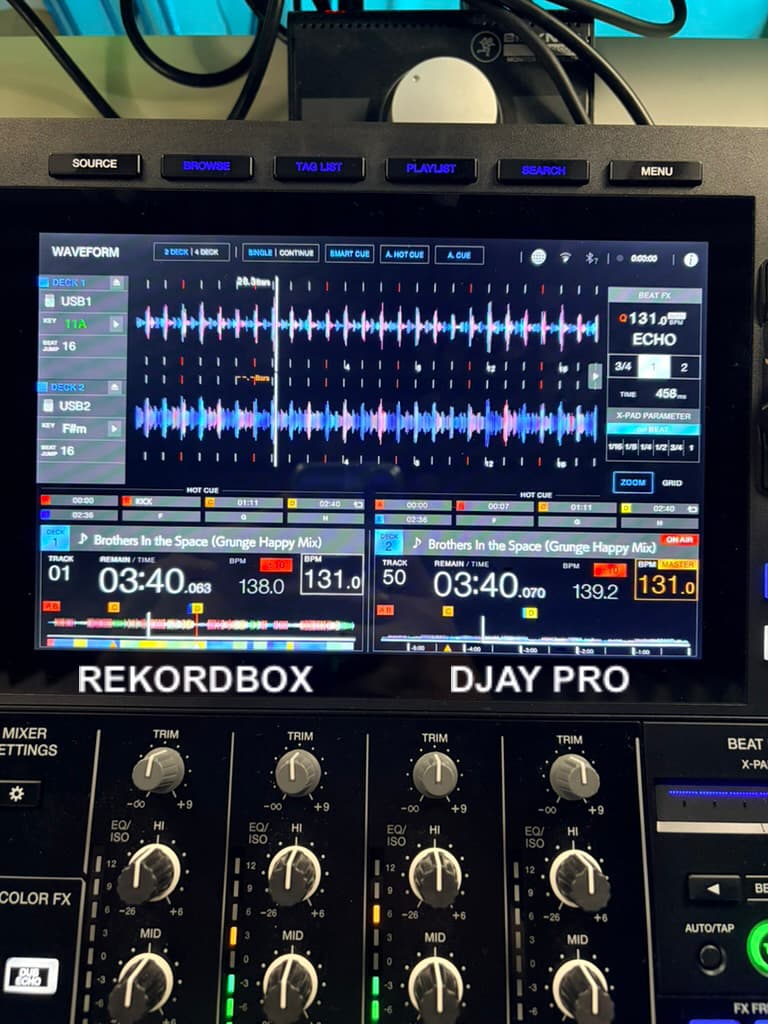

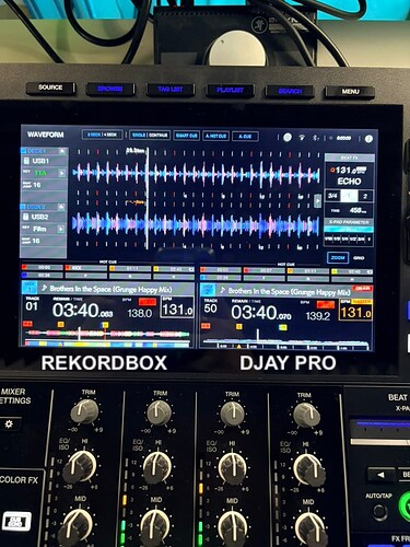

  1. The waveform for a song (any song) is displayed much smaller and with less defined colors than that of the same song imported with Rekordbox. This makes it difficult to see what’s supposed to happen during the song by looking at the display.
    (I’m attaching a photo of me loading the same song from two different USB sticks, one with Rekordbox and the other with Djay Pro).

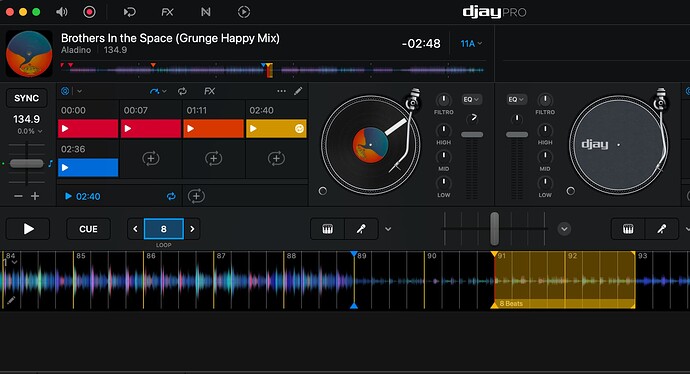

  2. Loops saved on Djay Pro don’t play automatically like they do on my Mac/iPhone with Djay Pro or with tracks imported with Rekordbox (using Memory Cue). I’ve attached photos.

  1. Regarding #1, our engineering team was able to reproduce this and they are investigating further.
  2. Regarding #2, exporting Saved Loops is not supported. You will need to use the new Cue Loops instead: Saved cue points and cue loops | Algoriddim Support
