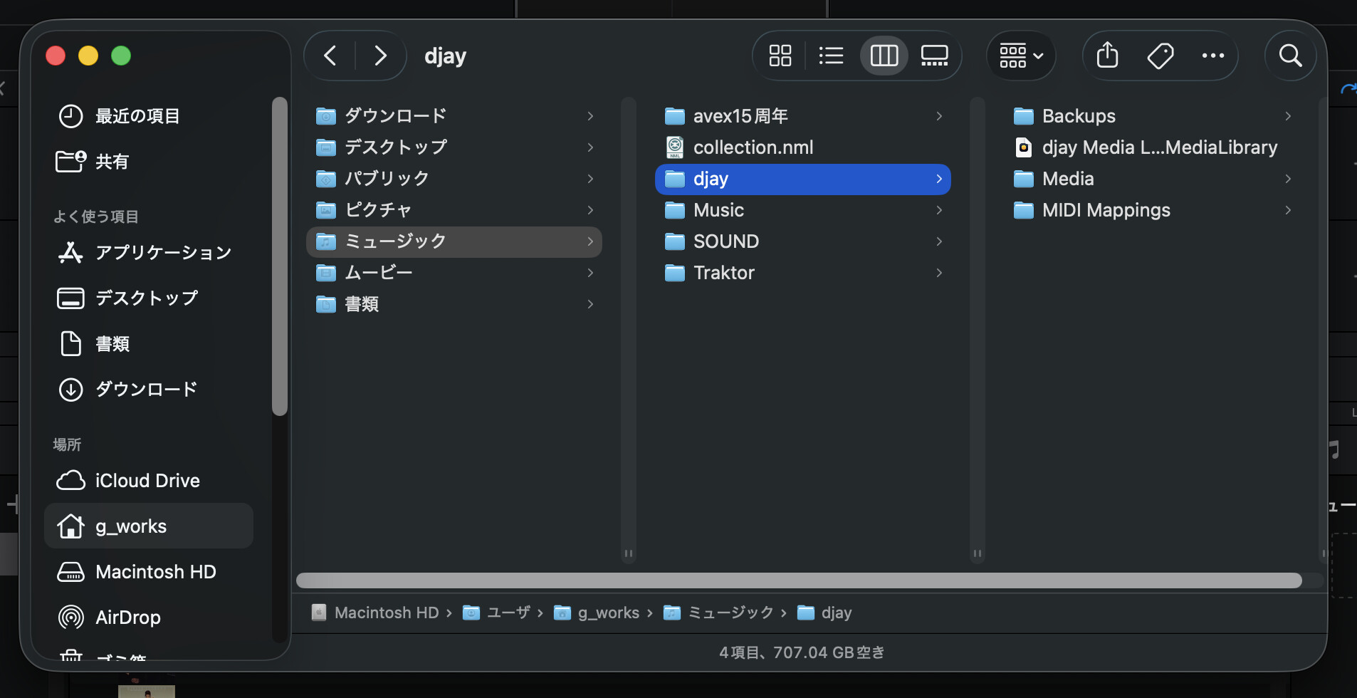

Hi @megamema, I’ve never had any issues using my MIDI mappings across iOS, macOS and Windows. However, I normally create them on iOS then copy them to macOS and Windows. Are you sure you’ve placed them in the correct folders on macOS and iOS? They need to be copied to the main djay folder not the User Data sub-folder.

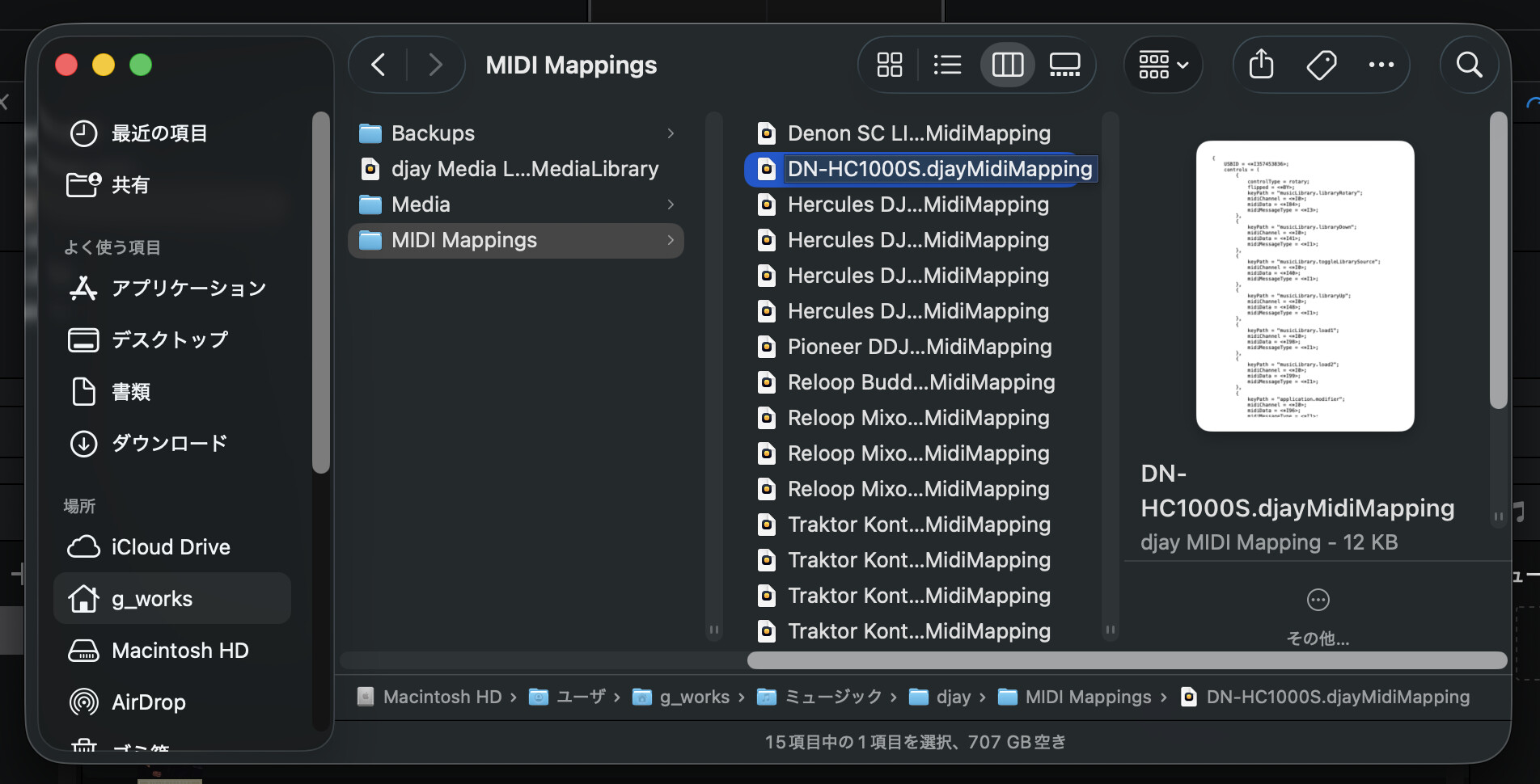

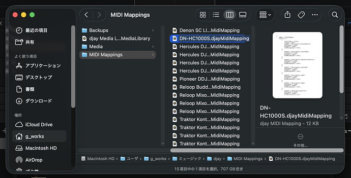

I save them in the folder created when I duplicated the MIDI file in Djay.
So I think the location is correct.

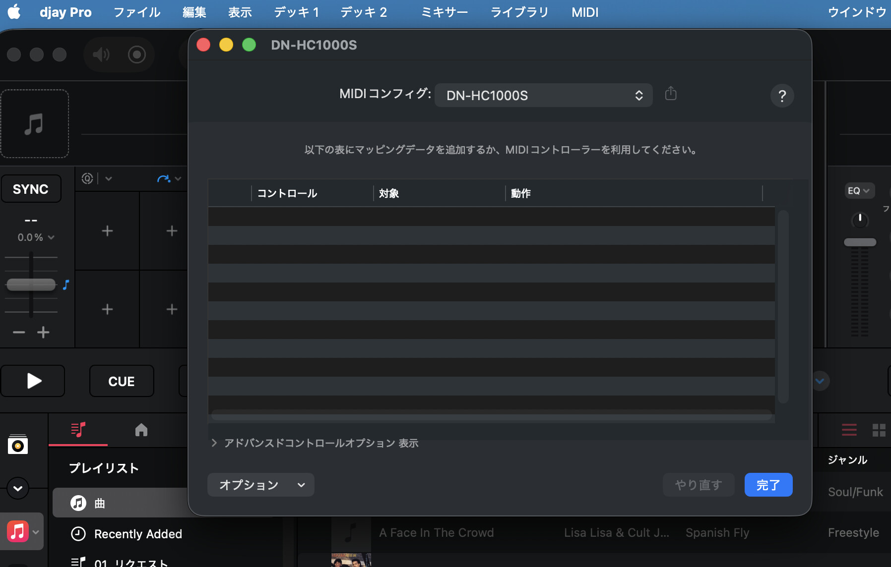

I tried loading the MIDI map created on Windows into the Mac version. It seems it isn’t being recognized after all. For clarity, I used a DENON DN-HC1000S, which is not supported by djay.

I tried it with 5.6.4 right away.
I tried it with Mixon 4, but it seems that the MIDIMAP I created on Windows, which I had backed up previously, cannot be imported.
