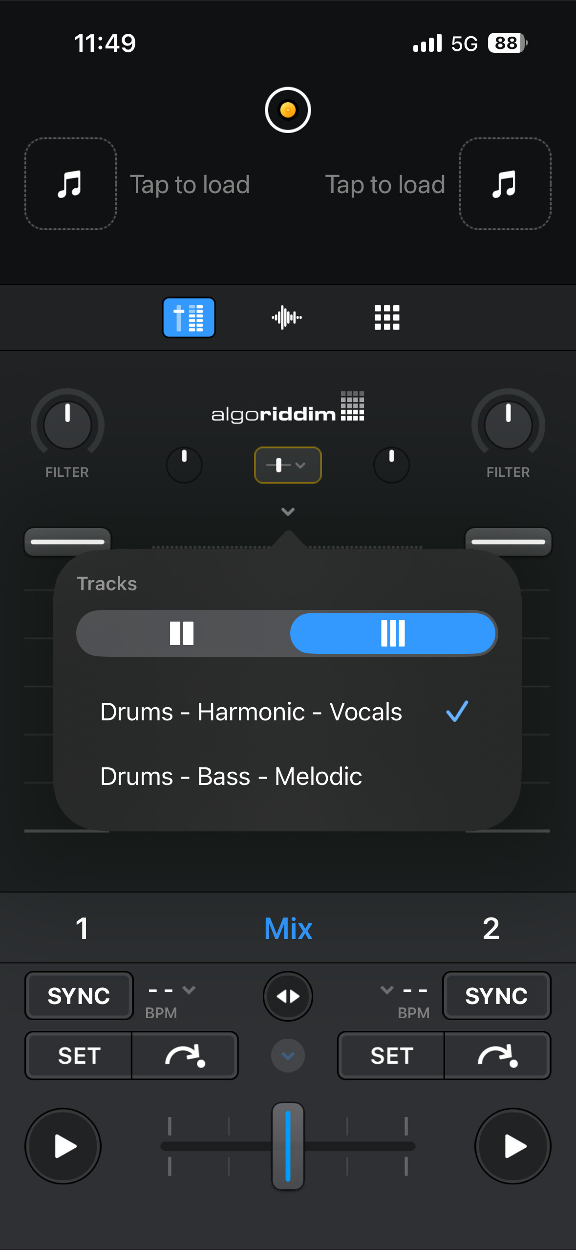

4 track NeuralMix option gone on iOS 27 / iPhone 18 Pro?
  • Device model: iPhone 18 Pro Max
  • Version of operating system: iOS 27
  • Hardware/controllers used (e.g. Reloop Mixon 8 Pro): n/a
  • Hardware firmware version (e.g. 1.0.1): n/a
  • It seems like the 4 track option is gone (Drums, Bass, Harmonic, Vocals). Only 2 and 3 track options are there.
  1. Open app. Open neuralmix.
C) EXPECTED RESULTS:
  • Should be option to choose 4 tracks, but only 2-3 are present.
D) ACTUAL RESULTS:

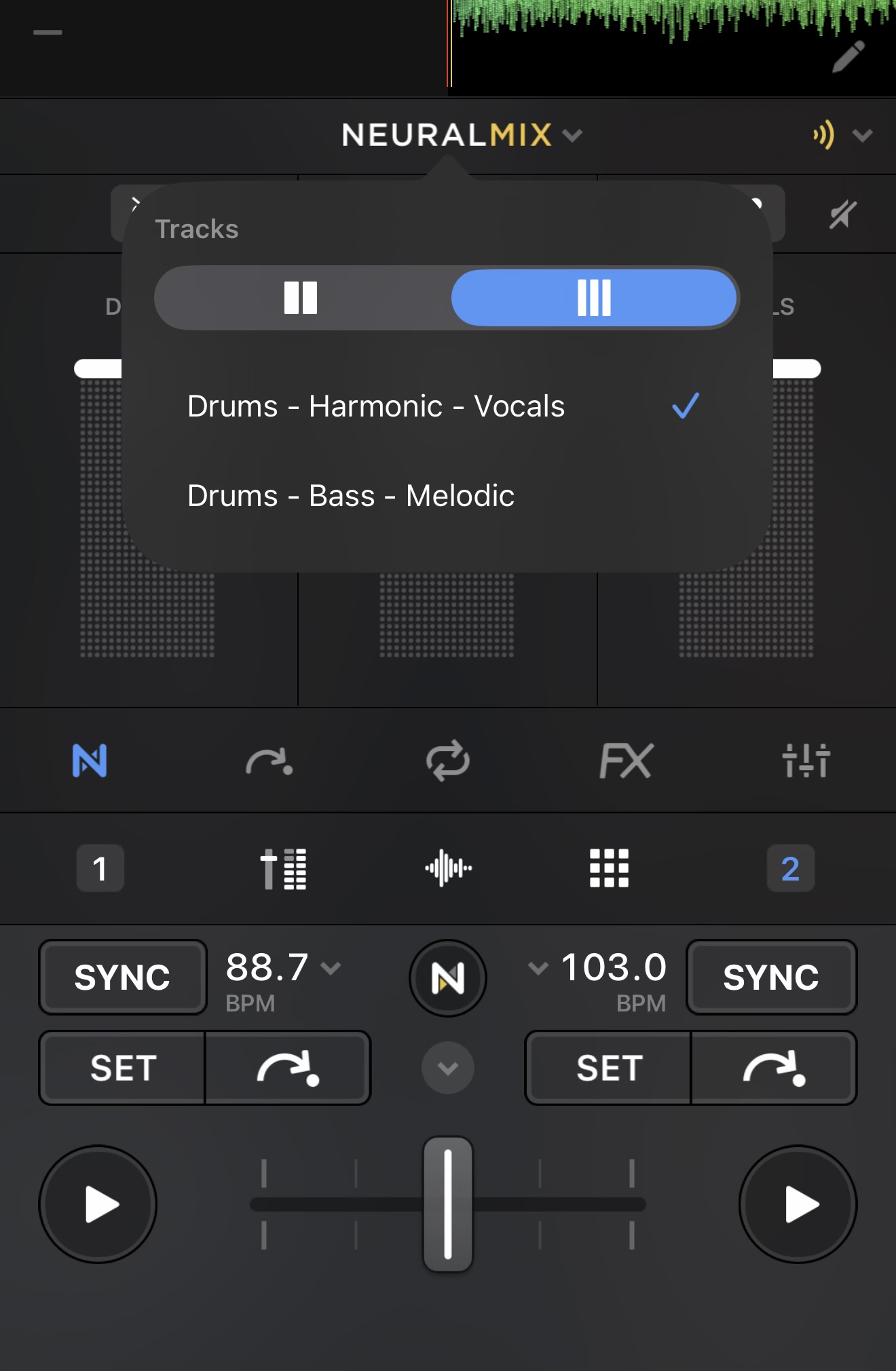

  1. On iPhone 18 Pro Max running iOS 27.0.1 using DJay version 5.6.9, 4 track stem separation was reduced to 3 tracks.
  2. I’m running the previous version on an iPhone 13 Pro Max running iOS 26.(something), and 4 tracks are available, and it’s running smoothly!
  3. My question is… why the reduction? What gives, algo? :cry:
Hi @JasonSwizzle, thanks for sharing. This is a known issue and I’ve merged your new topic with this existing one. Please see above for more details.
Thank you for your help and attention to this matter!
Here is a video to confirm the problem.
iPhone 18 Pro Max (T-Mobile), iOS 27.0.1, Djay version 5.6.9
