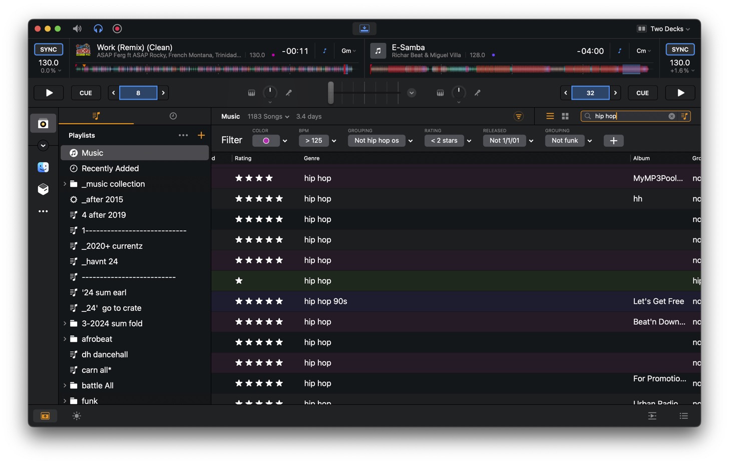

Hi, when searching in library and any of the library filters are selected, the results aren’t working correctly. For ex. if you search hip hop, you also get dance, reggae, ect… but when none of the library filters are selected, it works correctly and the results will only show hip hop.

The Track Filters and Search Bar do not interact; they are independent of each other and do not modify each other’s results. Each method will create a completely new track list and overwrite the contents of the Track Window.
  • The tracks in your 1st example look like results from the Track Filters.
  • The tracks in your 2nd example look like results from the Search Bar.
Notes:
  • For reference, your Search Bar is set to search the Current Playlist.
  • Hyphenating the genre Hip-Hop can make searches and filters more accurate.
