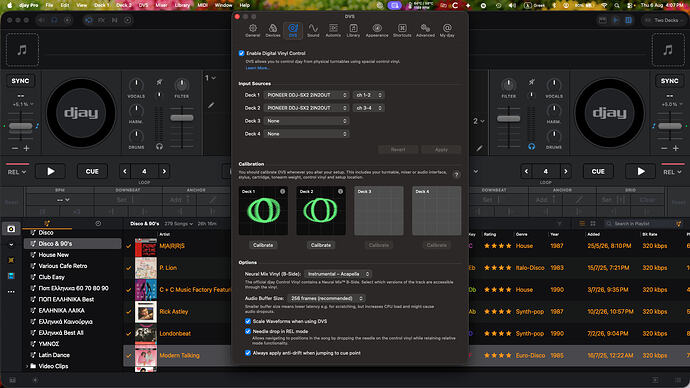

I have successfully configured DVS in djay Pro 5.6.8 on macOS Tahoe using a Pioneer DDJ-SX2.
My setup is:
  • djay Pro 5.6.8
  • macOS Tahoe
  • Pioneer DDJ-SX2
  • 2 turntables (Technics SL-1200 and Audio-Technica AT-LP120XUSB)
  • VirtualDJ timecode vinyl
  • DVS calibration is excellent on both decks (clean circles, stable signal)
Everything works correctly in Relative Mode. Tracking is accurate and playback is stable.
However, Absolute Mode is permanently disabled (greyed out).
When I open the deck mode menu, djay displays the following message:
“Control signal supports relative-mode only.”

Hi @djleokar, thanks for the setup details and screenshot. That message points at the control signal on the record, not the DDJ-SX2. djay doesn’t gate DVS modes by controller model. Absolute Mode needs the record to tell djay where the needle is, and djay isn’t reading positional data from your VirtualDJ timecode, so it’s offering Relative only. djay officially supports the djay Control Vinyl plus any standard 1 kHz timecode record. I suspect that your VirtualDJ timecode record may not be 1kHz.
In the meantime, you can get needle drops without Absolute: enable Settings > DVS > Needle drop in REL mode. Dropping the needle jumps to the matching point in the track, and unlike Absolute you keep your cue points and loops. I hope that helps!
