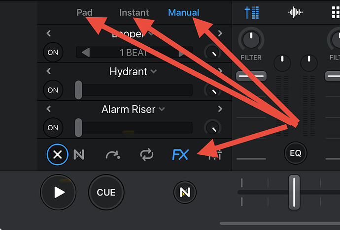

Hi at @tfmeier, the hardware FX section of the DDJ-400 is to the right of the EQs.
You can also control FX via your iPad screen when in Pro Mode. The screenshot below is on iPhone, but it looks pretty similar on iPad.

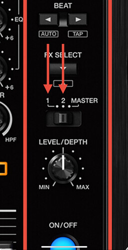

Ah, okay. That’s more clear now. Please make sure the FX Select switch on the hardware is set to 1 or 2 and not Master. Retest and let me know if that helps.
Ok, here’s how it behaves for me.
I can select the FX via the FX SELECT button but I can only change the first of the 3 slots - see screenshot.
Button 1, 2 & Master either select deck 1, 2 or both and then turning them on via the blue button activates the effect on either 1, 2 or both. So there’s no option to layer effects on the controller (e.g. using effect 1 & 2 on a deck which is probably more relevant for A/V or video FX). The FX slider (controlled by BEAT < & > is always applied to both decks.
Is this how this is supposed to behave which means I will have to active FX 2 and 3 on the app itself?
Hi @tfmeier, yes, it is behaving as expected. The hardware is MIDI mapped to only control the first Manual FX slot for each deck. If you want to layer multiple FX with slots 2 and 3, you will need to do this via the touchscreen on you iPad.
