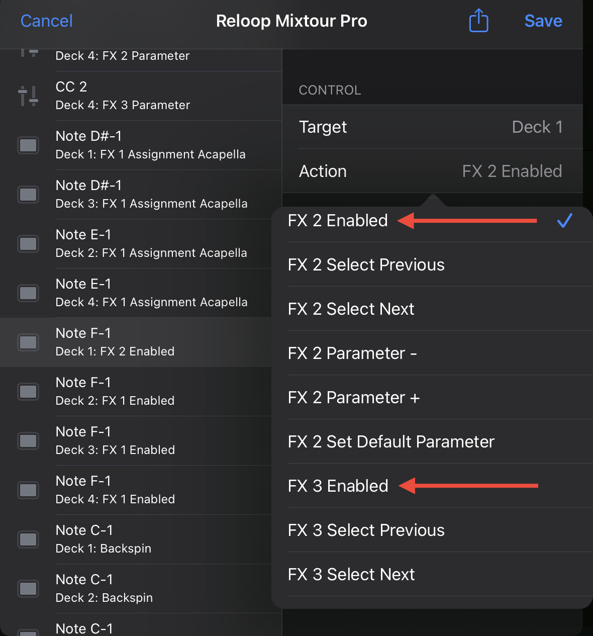

Hi @Ben4, you can’t do this via the Mixtour Pro hardware directly with the built-in MIDI mapping. However, I can think of a couple of workarounds for this:
  1. Manually press the onscreen “ON” buttons for FX Unit 2 and 3 while you have the FX paddle engaged.
  2. Create an edit of the (built-in) MIDI mapping and remap some buttons that you aren’t using to FX 2 Enabled and FX 3 Enabled for Deck 1 and Deck 2
If you’re not familiar with MIDI mapping in djay on iOS, please refer to the linked FAQ below: https://help.algoriddim.com/hc/en-us/articles/360016055199-How-do-I-MIDI-map-a-controller-on-djay-for-iOS

Hi @jltrulock, I’ve merged your topic with this existing one. The built-in mapping only controls FX Unit 1. Please see above for more details.
When you say manual press the on screen on buttons I am not sure if i follow what you are doing other than keeping them on.
Hi @jltrulock, I mean press the onscreen “ON” buttons for FX Unit 2 and 3 while you have the FX paddle engaged as shown below:

and I must be missing something on midi mapping, the shift isn’t mapped but it works, and while mapping it starts locking up.
I’m not trying to turn them all on at the same time. I am just turn them on. Without having toi click so much on a screen.
If i map a CC or sliger I get the option to Select an FX, but It changes FX and the amount and doesn’t actually make it active.

Hi @jltrulock, thanks for the clarification. In that case, if you want SHIFT + FX Paddle to control the Manual FX 2 Enable, make sure you change the Button Mode to Hold. This should allow you to enable FX1 OR FX2 using the hardware controls.
