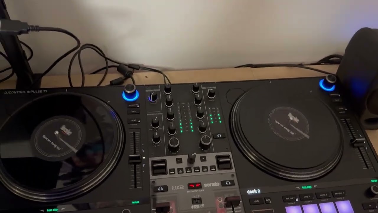

Hello @Slak_Jaw — apologies for taking so long, got super busy and had to record this again as the original recording wasn’t that good.
Good thing is that now I have upgraded to a Rane Performer, so I was able to compare, and it seems the issue is specific to the Hercules T7. I believe this is due to the fact it’s the only belt-driven motorized platters on the market.
Here’s a quick video comparing the T7 on both Serato and Djay on a Mac:

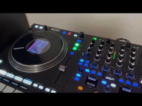

I’ve also did a video using the Rane Perfomer, and on it you can’t notice:
I haven’t used DVS on Djay yet, but I assume it might have an anti-drift setting. If it does have one, I would suggest moving to general playback settings, so it would be available to motorized controllers as well.
While it’s not noticeable on a direct-drive controller like the Performer, I am inclined to believe it will be for longer mixes. I can do more tests if you want, but on the T7 it’s really bad. I also have the impression it’s even aggravated on the iPad. I will do another recording tomorrow (I’ll sell the T7 very soon)
