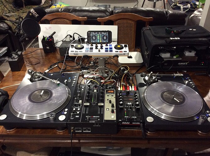

I advocated for the the amx kinda like what you’re doing now. If you look deeper in this thread then you’ll see my setup pics and different ways I used the amx :wink:
So it must absolutely have something to do with DVS. That seems to be the difference between our setup.
The issue is that the sound is not coming out the main and headphones. I have a few more things to explore before I make a bug report.
Here’s my dvs setup when the amx was working plug and play without rituals and workarounds.
