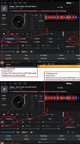

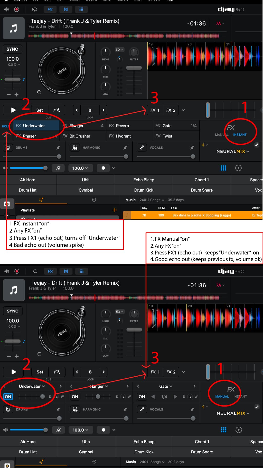

When playing a song and applying an effect via the Manual FX Panel or Instant FX Panel, adding an FX1/2 effect (e.g., Echo Out) should not override the initially applied effect. However, the behavior differs between Instant and Manual modes, leading to undesirable results in certain scenarios.
Observed Behavior
  • Instant Mode:
    • When an effect (e.g., Underwater) is applied in Instant Mode, and then an FX1/2 effect (e.g., Echo Out) is added, the system overrides the previous effect.
    • This causes a volume spike before the Echo Out effect is applied, making transitions in this mode unsuitable for smooth or creative mixing.
  • Manual Mode:
    • Adding an FX1/2 effect (e.g., Echo Out) after an initial effect in Manual Mode works as expected, creating the desired transition without overriding the previous effect.
  • Video Demonstration:
    (https://youtu.be/RX9JAr08fYs)
    The video illustrates the difference between Instant and Manual modes when applying FX1/2 effects, highlighting the volume spike and override issue in Instant Mode.
  • Screenshots:
    The screenshots show the differences in behavior when adding FX1/2 effects to Manual versus Instant FX, further clarifying the issue.

Hi again @Pato_Selekta, I spoke with engineering. The FX1 and FX2 buttons are essentially 2 more Instant FX buttons. Currently djay only supports having 1 Instant FX running at a time. So, pressing a second one automatically disables the first one. You can combine them with Manual FX though. I hope that helps.
I fully understand the design of Instant FX, where effects are applied one at a time, and how this differs from Manual FX. However, FX1/2 are distinct modules that should operate independently of the Instant or Manual FX systems. I strongly believe it’s both logical and essential for the engineering team to ensure these modules function separately to enhance creative control and prevent unintended interactions.

Hi again @Pato_Selekta, thanks for the additional information. I have confirmed with the engineering team that this is not a bug and the FX are behaving as expected. The new FX1 and FX2 sections were added in a recent djay release and they function as Instant FX, but in the different location for easy access. The current rule in djay is that only 1 Instant FX can be used at a time.
In the meantime, if you want to stack multiple FX, you can use up to 3 Manual FX at a time in conjunction with the FX 1 and FX 2 buttons for 4 total.
However, your points are well taken, so I’ve changed this topic from a Bug Report to a Suggestion. Basically, the feature suggestion would be to allow 2 Instant FX to be applied at once. So, in your case, this would also mean 1 Instant FX plus either FX 1 or FX 2 at the same time. Please confirm if this is the essence of what you’re after so I can submit the feature request in our internal system for the dev team to consider. By changing this to a suggestion topic this will also allow other users to upvote it so we can gauge user demand for this and prioritize development accordingly. I hope that helps. Thanks!
